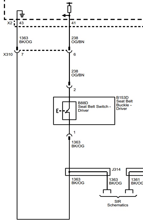

I'd rather determine if the buckle is grounding the line, or completing the circuit and set it up that way.
ETA:
It looks like the circuit is completed when the buckle is inserted into the receiver, so jumping the pins on the receiver side should make BCM think the belt is always latched.
I'd be wary about doing anything electrical. The belt switch feeds into the airbags and they are tremendously sensitive when it comes to electrical interference.
