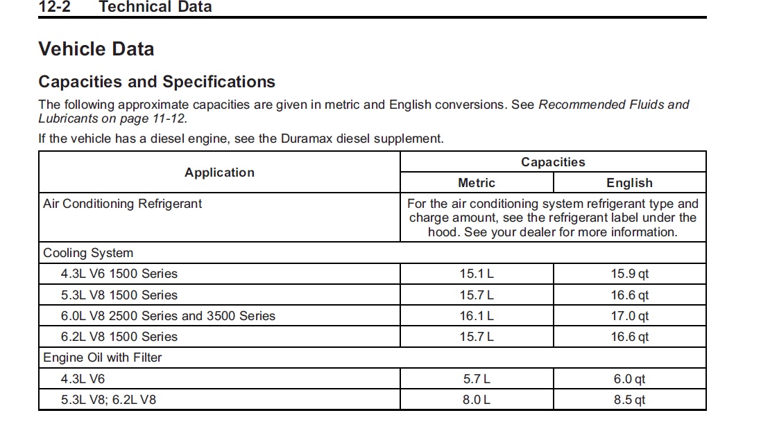

8 quarts for what??? I call bs
You're right. I was full of shit. The actual capacity is 8.5 qts..
Per the 2014 owners manual:
