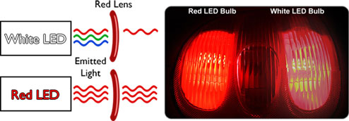

Thanks alot man; one last question
What about the color of the hight mount brake bulb ? White or red ?
With LEDs, always use an LED that matches the color of the lens - red-red, amber-amber. The pic below is from the SuperBrightLeds website.
