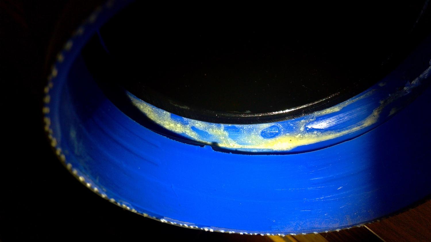

Almost forgot to post this. Back in November I had one of my ballast go out on my DDM HID lights. It was the passenger side light and to get to the bulb you have to remove the engine air filter box. When I began to remove the intake tube I noticed oil collecting in the boot that goes between the tube and air filter box. Looking down the inside of the tube I discovered more oil. I have since cleaned the tube and the MAF sensor and installed the RX clean side separator. I will inspect the tube again later to see if this has stopped oil from getting into the intake tube. I have had my Volant CAI with Donaldson dry filter on for almost 15,000 miles now (installed May 2014) and my RX catch can about 9,000 miles now (installed September 2014). I don't recall seeing any oil in the factory intake tube when I installed the Volant. I don't know why the Volant design would collect any more but I thought I would ask if anyone else has found oil collecting in their intake tube (factory or aftermarket). Thanks.

sorry to dig up an old post. I was just changing the engine air filter on my truck and found a puddle of oil in my airbox as well. my intake tube was also slick with oil too. Clean oil mind you, not like what comes out of my catch can. I have an Airaid MIT intake tube on my truck with the stock air filter box. I also have an RX catch can.
I have to say I was VERY surprised by this. I never had any oil build up with my stock airbox. I am gonna go out on a limb and say it's the Airaid. Might have to look into the RX clean side separator kit as well now.

And here is another video of when I was changing out my Air Filter. this is when I first noticed the oil pooling in the tube and intake box. Right around 3:30 I start to find the oil in the tube and box.
