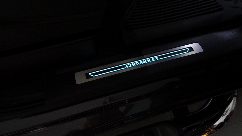

Got them installed last night. They fit perfectly. Wiring was easy except for the fact that they don't come with instructions. But I downloaded instructions from GM. Have done them before but couldn't remember connector and pin numbers. The wiring was exactly the same as Tahoe/Suburban as described in the instructions. I don't understand why they don't offer them for the pickups. All you need is power and ground. I used a ground on the left "A" pillar and connected the power wire to connector 7 (gray) pin 1 (gray wire) of the BCM and they come on with the dome lamps.They look awesome but I can't get a good picture that really shows the blue color. I think I took about 50-60 pic's but never got a good one.

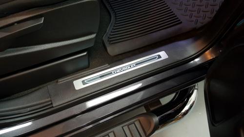

For those wondering if the OEM mats will block the logos, there is a cut out line already on the back of the mats. Just cut along that line and the logos will not be blocked. See my pictures for reference. 6ae31ab464bf597a9daaf1b9c42a8146.jpgea83473107b149937add790744df4a7e.jpg4367e61ef932a1bbb9fbdd0afbd0000e.jpgfd2833a5aa2a1f53d88a087278febfac.jpg
