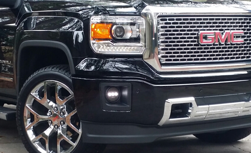

I have a 2014 Sierra Denali with a 6.2. I am wondering if anybody out on the forums can enlighten me about the cylinder deactivation mode. Can this mode be turned off? And if so please share how. I am not interested in fuel savings and I don't like the sound of the drone. I have the gmc Borla catback exhaust , slight drone is detected but would rather not have drone at all. Please advise. Thank you.
