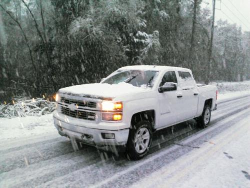

Ive looked at the forum for a while now, but ive finally decide to make a username. Ive got a 2014 Silverado Z71. Ive installed a 2'' rough country leveling kit and husky liners so far.
