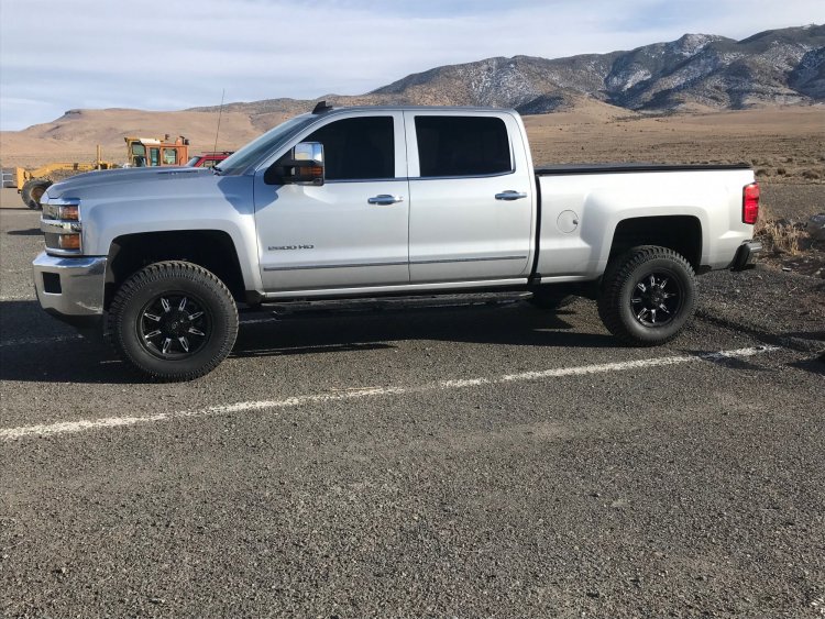

2019 Chevy 2500 HD Duramax with 45 miles! Front keys cranked up, shock extenders and 18x9 +12 offset with 295-70-18 Atturo XT tires. Slight rub on pass side front wheel well. Trimmed it up about 2" and everythings good!
