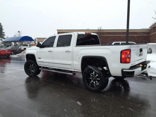

I just had my Zone 4.5" lift kit installed. I have 20" Moto Metal 970 wheels -24 offset with 33x12.5 Mickey Thompsons ATZ tires.
I really like the way the truck looks, but it rides like a box truck. I assumed the ride was going to be different but it's pretty significant and I feel every bump in the road now.

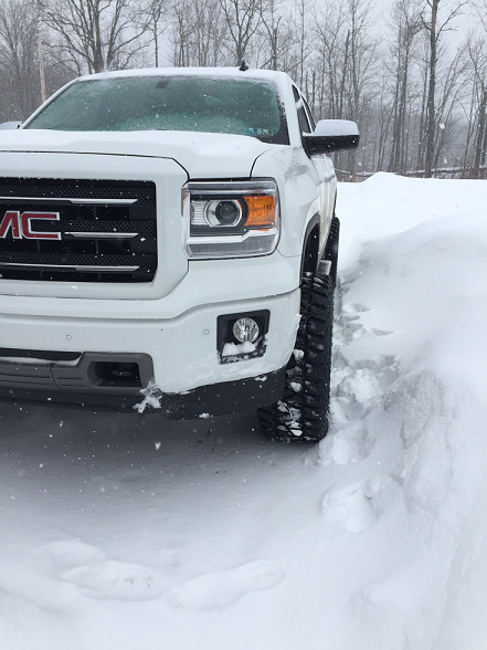

I don't have any solution to the ruff ride, but can you take more pictures of the truck, maybe some down the side to see how far the wheels stick out. I think it looks great.
This is all I have at the moment.

truck looks great! perfect height in my opinion. and I agree... its all in the tire. these trucks ride too soft anyways haha
