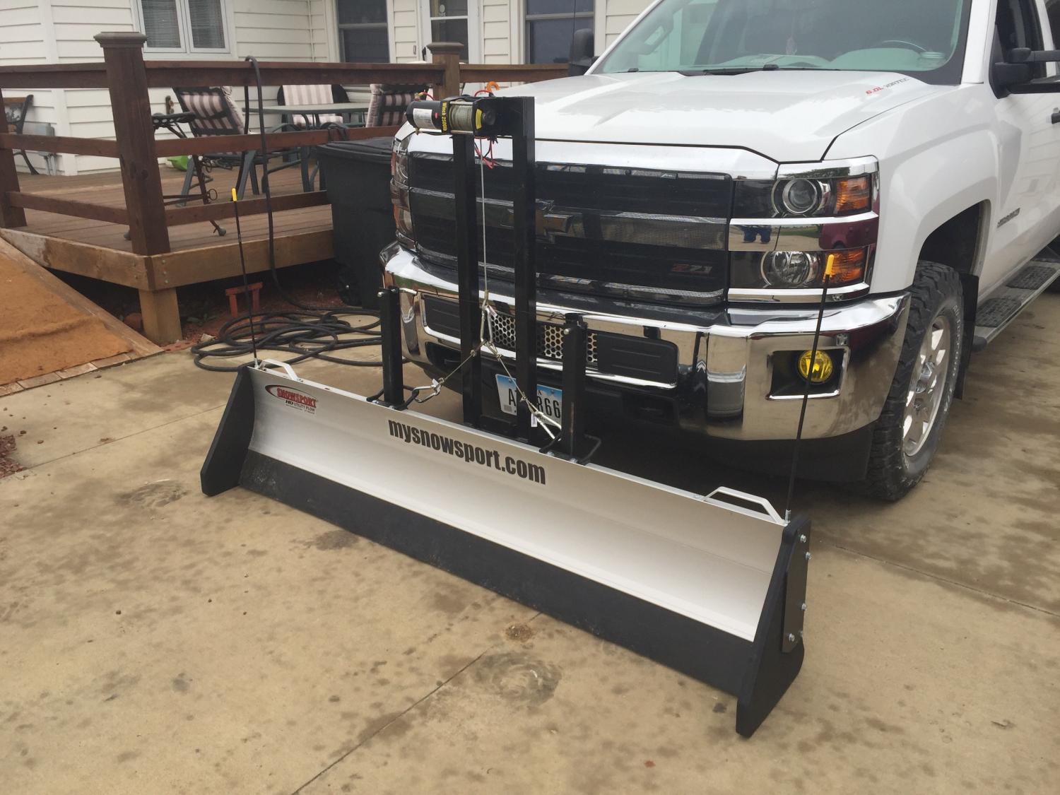

Got a Snowsport HD blade for my 2500. Have to move around and plow various areas, especially sections of gravel road 1.5 miles to the highway because we get hind tit from the county on snow removal, so have a winch mount setup that allows raising and lowering the blade from the cab for those short jaunts from one snow drift to another. Gave design I wanted to local fab shop and picked it up today. Just have to pick up a couple of small items at the hardware store in the morning and job will be done. Got a 2500 lb winch with wireless remote off Amazon for $60. Anyone could get a similar winch and remote at Harbor Freight for similar amount. The fab shop did great. Looks like original equipment for the Snowsport blade. Total cost of entire setup under $1500. Will post a few pics of the setup when I get it finished tomorrow.
Finished Snowsport HD setup. Added a mount and winch setup to it I had a local fabrication shop put together for me. Total cost of entire setup (blade, mounts, winch, etc) under $1600. Wireless remote. Got the winch and remote off Amazon for $60. Harbor Freight has similar units with wireless remote for equivalent pricing.
