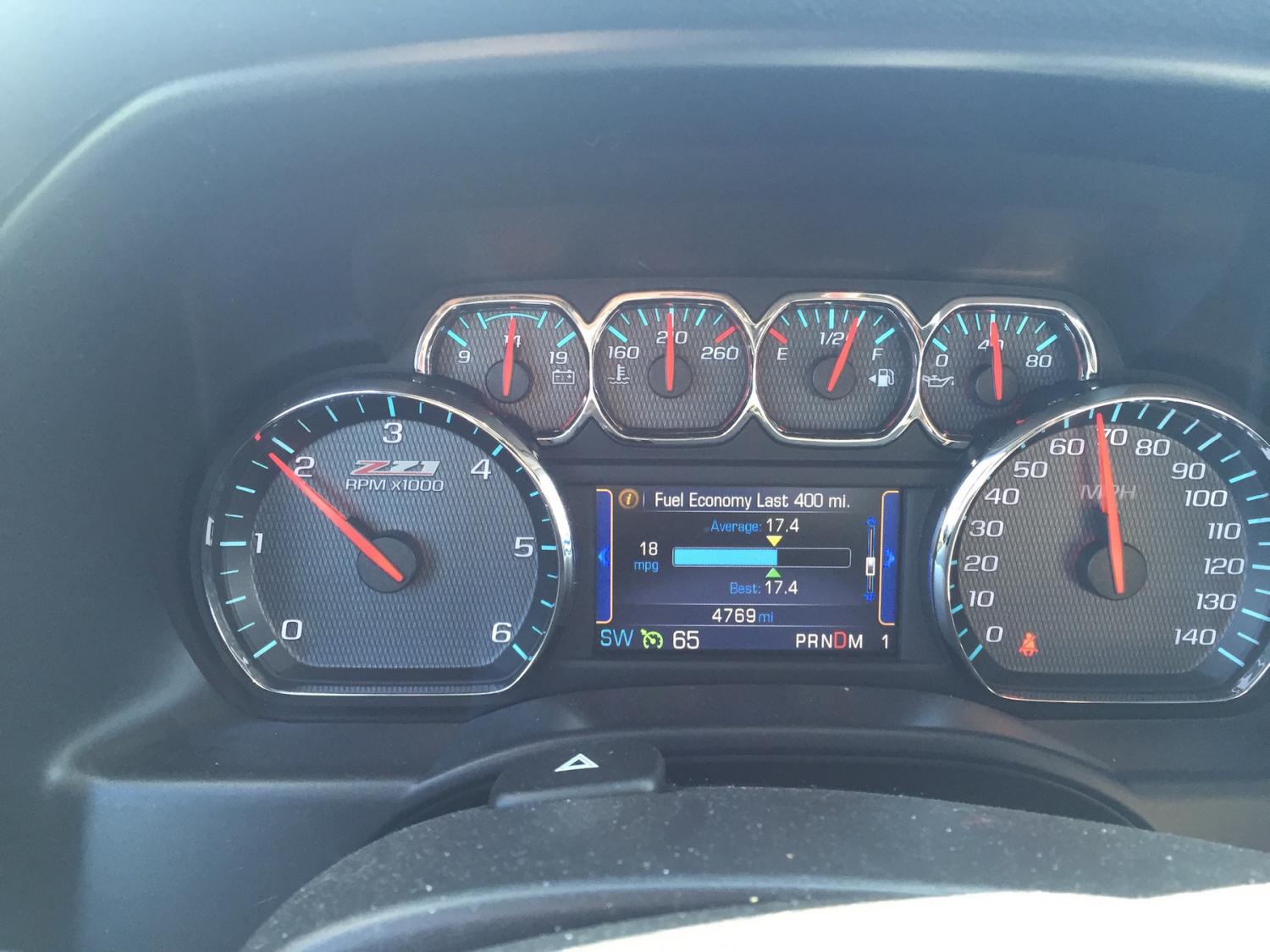

I realize my mpg on the 2500 is suspect. And I will agree it is outside the norm. But then, over 5 million logged commercial driving miles has helped me develop techniques to get the most out of a vehicle. I average a solid 20% better fuel economy with my semi truck than the general freight OTR sector national average. That is 6.5 mpg. I dumped the ECM recently and it had a lifetime average of 7.83 over 400,000 miles. last month, everything worked out great to where the average was a solid 8.5 mpg, Considerably higher than the OTR sector average. And when you factor in that a simple 0.1 mpg increase, taken over the typical year, is roughly a $600-$800 dollar savings in fuel over the year, imagine how much more profit i obtain by getting the mpg's I do compared to the average truck operation.
To satisfy your curiosity on mpg with the 2500, here is a pic of the DIC on a road trip we took the week before Memorial Day. I hand calculated as well, and the difference was only .003 mpg. This has been typical of all road trips so far. Wife took the pickup to Missouri to a friend's wedding recently, and averaged 17 for the trip also. So it was not just me. Maybe she learned a thing or two on how to drive a vehicle over the years from me. And this was on that sorry 10% ethanol fuel that everyone has a fit over (only E15 I get is at home area, couldn't find it on the road). Might even get better mpg if I filled with non ethanol.
If folks aren't getting somewhat similar results, the fault probably lies with the person behind the steering wheel. After all, fleet studies have shown that the driver has a 33% average effect on fuel economy. But it is so much more satisfying to blame the equipment than ourselves.

That is pretty impressive. Must have been the wife's doing! My wife always gets 1-2 MPG better than me.... Moderate speeds do wonders for your mileage. But I will contend, in the conditions in which you got that result you would have had 20+ at the minimum with a stock 6.2.
