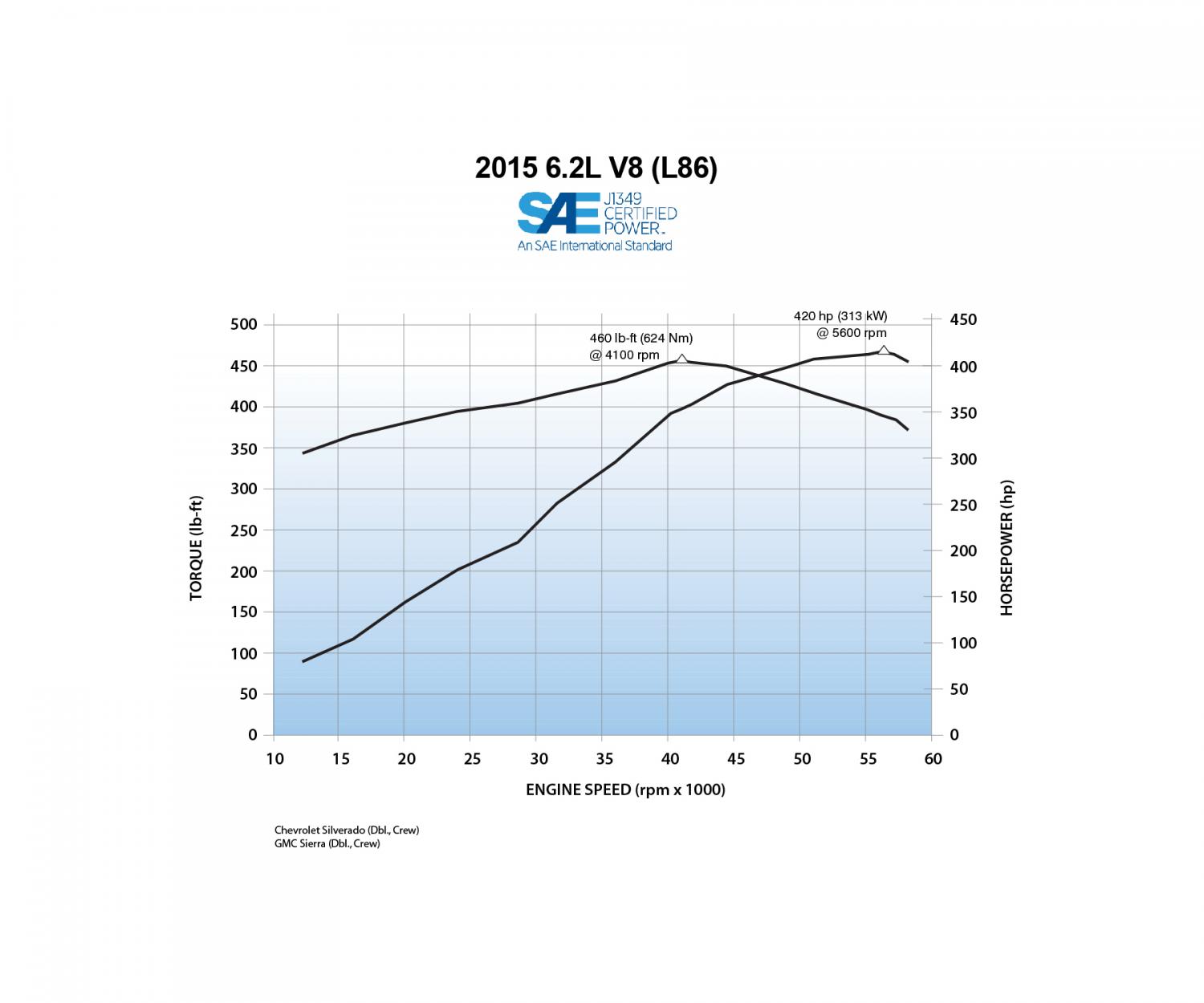

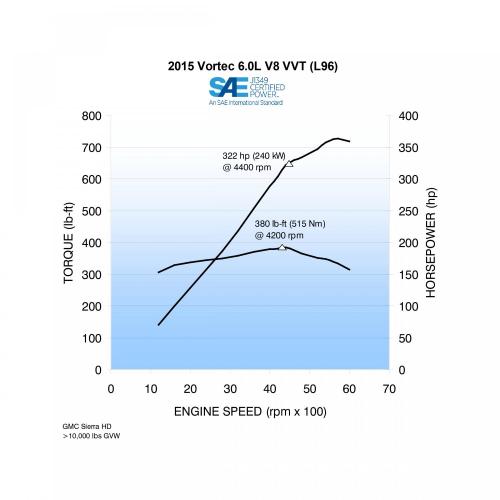

You’re right, it’s not. It’s much more powerful and much more efficient.
We are purely speculating anyway, as there is no testing showing the 6.2L doing 20,500 GCWR up the Ike Gauntlet as the 6.0L has done. We only have the Ram 6.4L, which is virtually equivalent in power to the GM 6.2L Ecotec, and that got blown away on the Ike Gauntlet by the 6.0L in the 2500HD, which by the way, was loaded 300 lb heavier than the Ram 2500 it was up against.
Wow, now you’re trying to plaster the 6.2 with the sad, pathetic performance of Ram’s 6.4? Based on what? The 6.2 does not have a reduced power mode it will go into during a long tow as we saw with the 6.4. I’ve looked deep into the 6.2’s programming—it’s just not there. It’s like saying you think Tom Brady will have a bad year next year because he and Jay Cutler are similar players and Jay Cutler sucks. There is no technical relation. Saying the same thing might happen is nothing but pure fanboyism. We have seen multiple tests where the 6.2 is held at WOT for extended periods of time—it just keeps pulling strongly as long as you want.
Numbers on a sheet can be impressive, but how it plays out in the real world is quite something else.
This is getting ridiculous. There is simply zero technical reasoning for you to make these statements. There is no rational reason to expect the 6.0 could even come close to keeping up with the 6.2 when towing the same weight.
If one was turbo and the other wasn’t, you might make a case that the sea-level dynos don’t reflect how they’ll perform at altitude…. But that’s not the case. The engines are tested to the same SAE standards and environmental factors will affect them both equally on a percentage basis.
The 6.0 is 60 HP and 80 lb-ft behind. Not just at high RPM where it might not be all that useful, but even at just 2000 RPM the 6.2 has a 50 lb-ft of torque advantage. It’s not even close. There is no technical reasoning, no rational reason to believe the 6.0 could come close to keeping up—much less beating the 6.2 towing the same weight up a hill. Saying so can be based upon nothing but pure fanboyism.

I have also studied the dyno charts on both the 6.0L and the 6.2L. The 6.0L reaches 90% of available torque at 2000 RPM and the 6.2L only reaches 75%, maybe 80% at best, of available torque at 2000 RPM. The 6.0L torque curve is a little flatter thru the RPM band. No, the 6.2L at 2000 RPM is not 50 lb torque ahead of the 6.0L at 2000 RPM, but more like about 25-30 lb, to be optimistic. Your contention that the 6.2L has 50 lb more torque at 2000 RPM is fallacious. The curves are not comparable across the RPM band. But it still remains, how a motor uses the available torque efficiently is still a factor. Overall design comes into play from the intake to the tip of the exhaust. If I have learned anything from putting together commercial semi truck specs, I have learned that. Heavy truck diesels that have only 1650 lb torque can walk all over other trucks that have 1850 lb torque motors all day long if they are spec'd properly throughout. There is a lot more that goes into making a motor effective than what it does on the dyno.
I have also studied the dyno charts on both the 6.0L and the 6.2L. The 6.0L reaches 90% of available torque....
90% of much less, is much less.

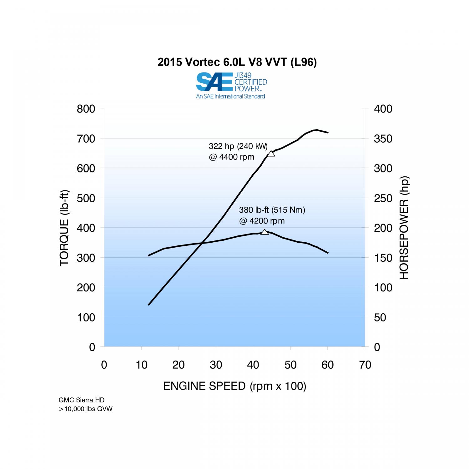

You can have your own opinions, but not your own facts. More closely studying the official sheets ( http://gmpowertrain.com/2014_images/charts_lg/2015_60L_L96_SierraHD_10M.jpg http://gmpowertrain.com/2014_images/charts_lg/2015_L86_6_2_V8silSie.jpg ) and using a caliper to interpolate, I come up with 381 lb-ft for the 6.2 at 2000 RPM and 337 for the 6.0.
That's a difference of 44 lb-ft. No, not quite the 50 it looked like at first glance, but if you're only seeing 25-30 you need to have your eyes examined.
This is just meaningless mumbo-jumbo. We aren't comparing drastically different engines where different dyno techniques are required to get an idea how they'll do on the road under load.... They're both N/A gas engines virtually the same size. When one shows a 44-80 lb-ft advantage throughout the entire RPM range, pretending there may be some way the other engine wins any sort of contest is akin to saying 2 + 2 = 5 because that's the answer you like better. Irrational fanboyism in the face of contradicting facts.
Couldn't get your link to work. Here is what I used. Granted my eyes aren't calibrated, but from what I see, the 6.2 is, at best, roughly 375 lb torque at 2000 RPM. The 6.0 is roughly 350. Calculating it at 90% for max, would put it around 342. Still the 25-30 lb difference I mentioned.
OK, maybe you need some help reading a chart. 1/2 way between 350 and 400 is 375, right? With your bare eyeball you can clearly see the 6.2 is well above 1/2 way between the two values at 2000 RPM. Actually measure it like I did and you'll get very close to the 381 I did. 1/2 way between 300 and 400 is 350. The 6.0 is significantly below 1/2 way between those values, only a little better than 1/3 of the way up (which would be 333)--thus my estimate of 337. That's a difference of 44 lb-ft. One may be able to quibble over 2-3 lb-ft on each measurement, but the only way you could come up with 25 is if you're looking at the charts crosseyed.
As neither engine is going to pull the heaviest trailer up the steepest hill at 2000 RPM, it is a bit moot though. I know you want to pretend the differences at higher RPM don't matter, but they do. When you're towing with a gas engine, it's going to run a gear or two lower when the load is high, that's just the way it is. That's what they do best.
The other day I was pulling a trailer up a pass and it did downshift into 3rd, pulling it up at about 3500 RPM. The difference there is about 55 lb-ft. The 6.0 with the same gearing may have needed to downshift another gear. With 4.10's and stock tires, the engines would have been at 4500 RPM in 3rd...where the advantage is 75 lb-ft....or 3400 in 4th where the advantage is 50+ lb-ft.
While the torque at 2000 RPM is of some interest for drivability and how the engine can pull moderate loads up slight grades without downshifting, it isn't that meaningful for heavy towing up big hills. While, as stated, the 6.2 does have a significant advantage at 2000 RPM, in the RPM ranges used by these engines when doing heavier towing, the advantage of the 6.2 just gets bigger and bigger.
