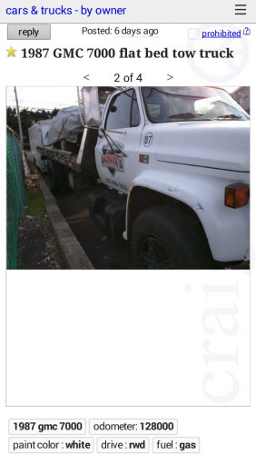

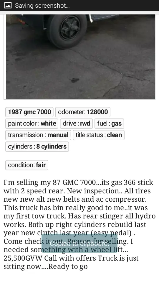

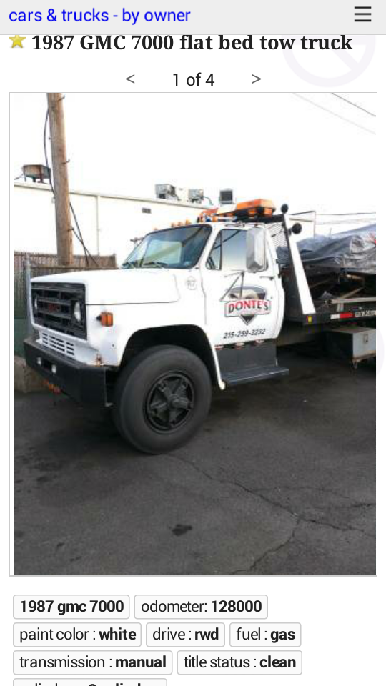

Hi, I just recently put a down payment on a 1987 gmc c7000 rollback. I got a copy of the title and it it says the unladen weight is 21,000 pounds and gvwr is 25,500. I'm hoping the title is wrong when it says the unladen weight is 21,000 because that only leaves 4,500 pounds I can load on the bed. The truck is a 1987 gmc c70 with a 366 motor, 5 speed and 2 speed rear. Also it has a 19 foot steel jerr dann rollback bed and a stinger bar I think it's called. What do you guys think it might weigh? Or does anyone have a similar setup and knows what it weights? Thanks

The 21,000 pounds sounds a little on the heavy side. Most likely that truck is registered under weight to stay out of CDL/CMV territory, that's a pretty common practice with flat bed wreckers. A C7000 should have a GVWR from the factory in the 32,000-35,000 range.
You can probably register it at a heavier weight, but that'll need to be weighted against potential extra cost in taxes, licensing, regulatory fees and insurance cost.

Thanks for the info. I did think 21000 pounds did seem a little heavy. I talked to the guy I'm buying the truck from a few days ago and he claims it's about 13,800 Empty. I do like the truck because I'm a big fan of gm trucks and it's in good shape with working A/C and not much cab rust, but the seller started to get a bit fishy. I sent him a text off a different phone number so he wouldn't know it was me and asked if the truck is still for sale and he said yes even though I put money down and we have a written agreement. So I might be backing out of buying it so I don't lose anymore money. Will find out this weekend when I stop by his auto repair shop over an hour from me. I've bought a few trucks on Craigslist like this and first time I may be getting ripped off, but lesson learned. Lol
Also I was kinda surprised a gmc c7000 came from the factory under cdl and when I decoded the Vin it must have or was retitled under 26001 pounds. The Vin is 1GDJ7D1B6HV505106. Thanks again for your guys help with this truck. I'm gonna try and dig a little deeper into the history of this truck and hopefully all works out. The new obstacle is now getting the seller to let me tow the truck to my house for extra security while I'm paying him off or I'm just gonna cut my losses and try and get my deposit back.
