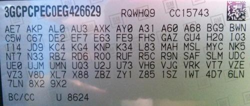

I just bought a 2014 Silverado crew cab WT with power locks and windows. Is it possible to add keyless entry? I googled the topic and got mixed results. For clarification purposes, I do not want to add remote start, only keyless entry. VIN # 3GCPCPEC0EG426629

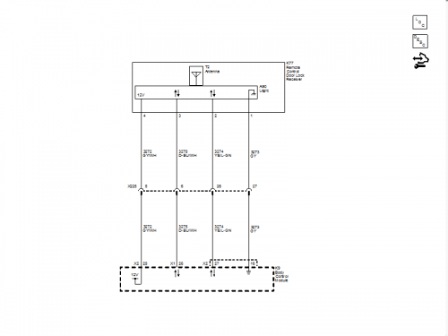

you need to know first if you have this module ( k77 Remote control door lock receiver)
and if you have every wire or harness it need
then if you have it you just have to reprogram the bcm but you need someone who will do it for your serial number
it's why your dealer tell you it's not possible.....they can't reprogram something else than what it's on you truck when came out from factory
it's only a programmation so obviously someone can do it and pretty sure even on this forum
but first check for this (it's schematic from your truck 2014 silverado 4x4):

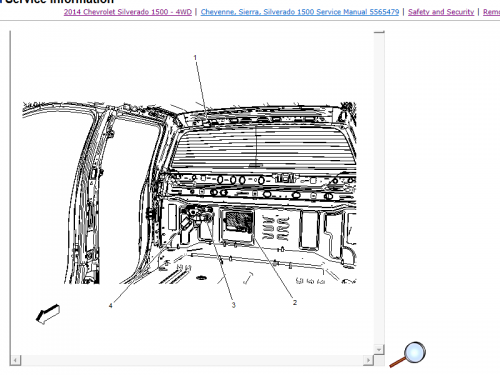

Anybody know where the receiver module is located?
because you don'T have JK1 ( tire pressure monitoring system) and AQQ ( remote door lock , remote function) you probably don't have the module and/or wire/harness
on the picture you see the back glass
the module is the number 1
