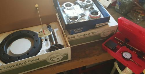

I have the front done. Took about 4 hours. That was messing around and my first time doing it. I'll be doing the rear next week. I already have the new bb tune ready to go.
I'm using a friend's shop after work so I only have certain time windows that I can do it. By the look of the rear I'd say 2-3 hours. So you could do it all I see day. Well worth it if you are mechanical.
