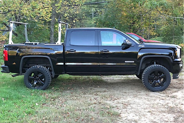

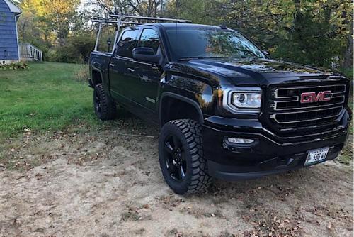

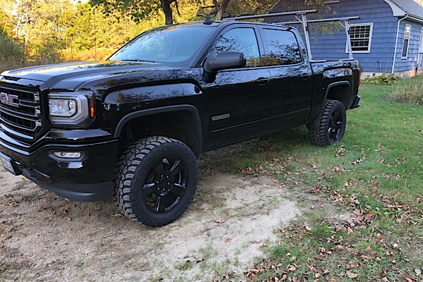

Got into a new 2017 1500 All-Terrain earlier last year and just getting around to a lift. There are two shops close by that claim it would be near impossible to run a Zone 6.5 or anything similar with my stock 20x9s and 34/35 inch treads. Is this just a lazy approach by the shop
I don't remember having such an issue with my 2014 that had 18" stockers, besides running spacers. Am I just barking up the wrong tree as far as the shops or am I missing something?
I think they are full of it I think the stock 20's would work fine.

Stock backspacing should be roughly 6" (6.06" for the sticklers). Zone states that 5.75" of backspace as the limit for running 35x12.50 on a 20" rim. So looks like a 1" spacer all around should do the trick?
post-178256-0-52721700-1507075773_thumb.jpegpost-178256-0-38341600-1507075798_thumb.jpegpost-178256-0-23509700-1507075758_thumb.jpegIf you have +27 stock 20’s put in a 1/2” spacer and you will be fine. I have a zone 4.5 with 33’s. No rubbing whatsoever. I just won a 6” BDS from Custom Offsets and they said I can run 35’s with this setup with no rubbing. Good luck.  You’ll have a whole new truck once it’s lifted
