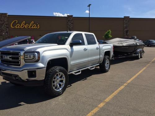

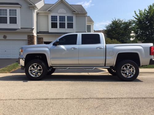

I also have stock 20s with 35x12.5r20 Toyo RT and the BDS 6inch fox coilover lift and they fit perfectly.  Only the stock 20inch or 22inch will fit the BDS fit.  Anything smaller will not clear the knuckle.  I have no rub and I even lowered the coilovers to 4.5" of lift and no rub.post-130528-0-20933700-1499777915_thumb.jpgmsg-130528-0-09109500-1506472962_thumb.jpeg

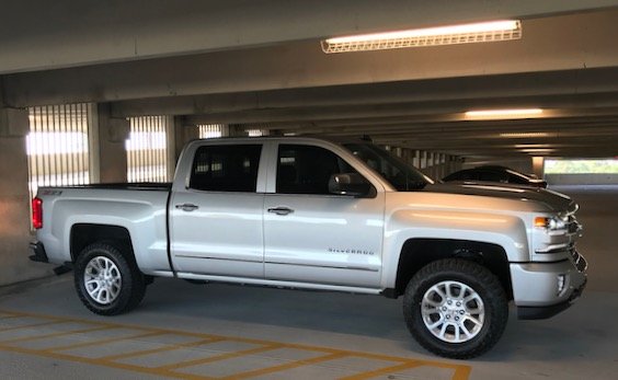

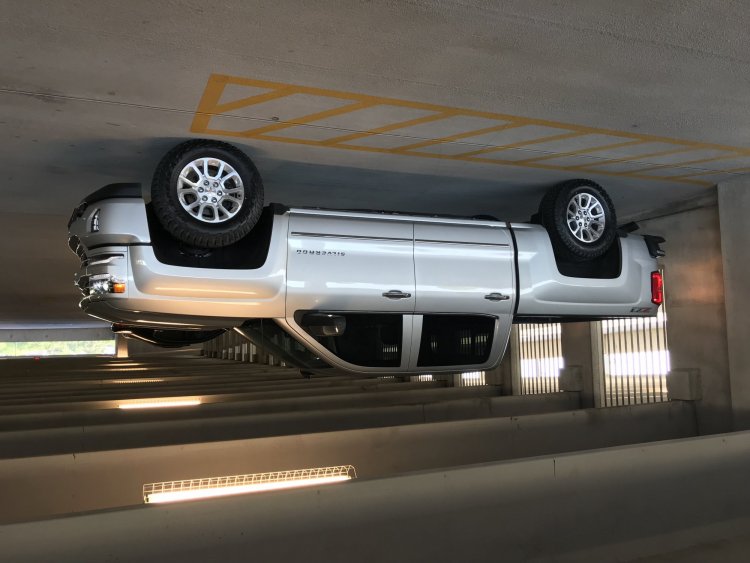

Ditched my aftermarkets for some OEM GMC 18's - Not a "lift" per say, but Bilstein 5100's set to 1.8" 285/65r18 Falken WildPeak AT3.
IMG_1913.jpg.8dd2c722edff18a40f117be0ac64e11b.jpgIMG_1897.jpg.0bdc62ec5b17975d36598d7184084cda.jpg
MacOS "Photos" inserts images in upside down... no clue why.
Edited by FHLH
lust installed the motofab 2" in the front.  running all stock 18s.  debating on a tire size.  was thinking 285/65R18 but not sure.  FHLH looks like mine, not sure if i should go any bigger

Like the look of your truck! Factory wheels with 35’s? 6 inch BDS?
Yes gm 20x9 wheels 35x12.5r20 toyo open country rt tires and bds 6 in kit.  The front fox coilover were adjusted down 1.5” to give it some rake and make the cv axles level. Bds didn’t offer a 4 inch kit with fox coilovers when I installed but they do now. I have no rub at all

You didn’t have to add any spacers to the wheels? Ride quality? I’m just checking before I install on my Denali

Would you go with the 4 inch kit now? 6 too high??
