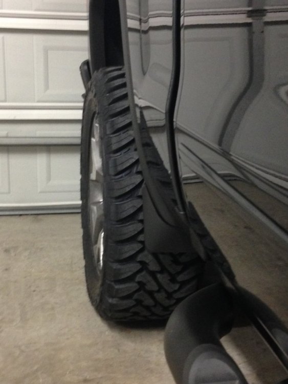

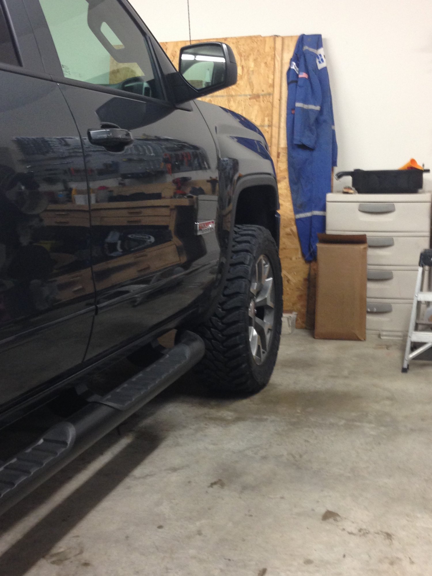

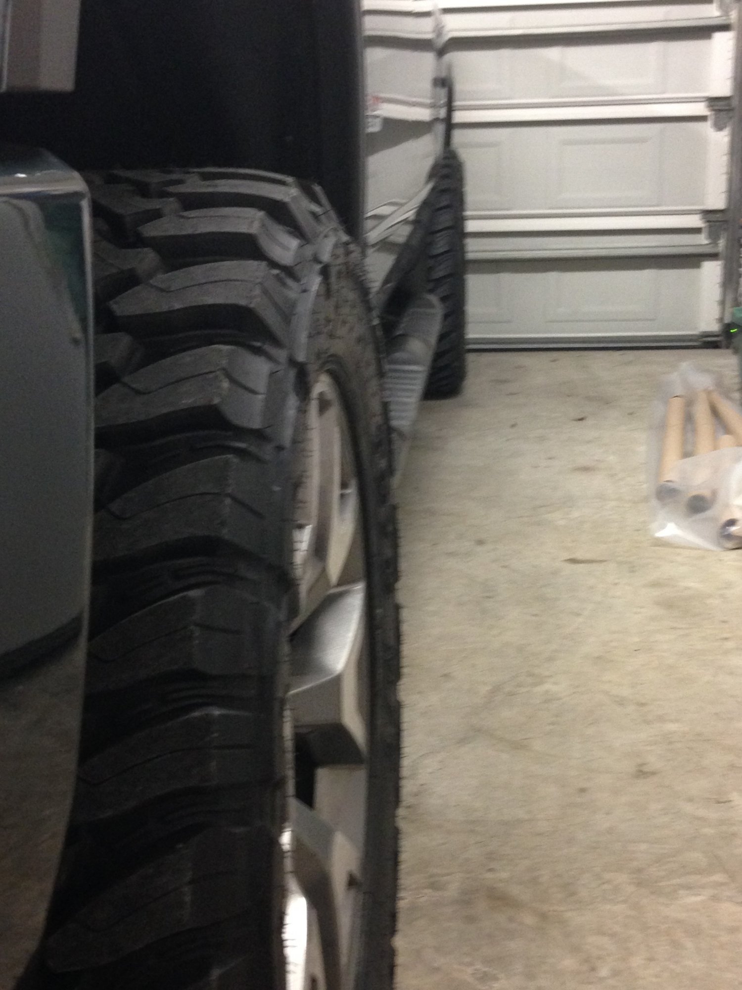

A few pics of the final result taken after the spacers were installed. Sorry for the crappy pictures, but it was dark outside and just took these to send to my son.
I can take a few more in daylight hours if anyone is interested in how the end result looks.

A few more if interested.

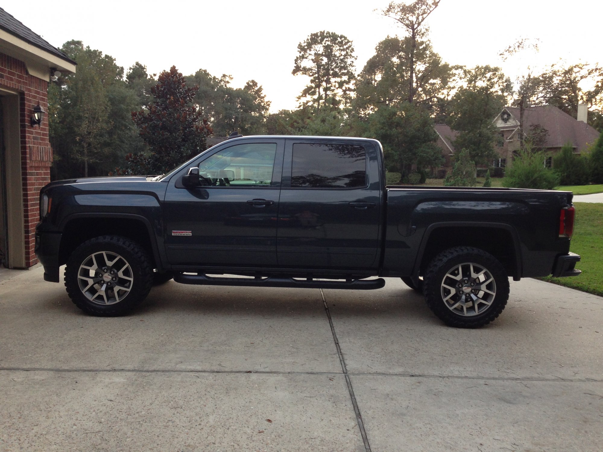

Nice write up! Have any full side shots?
CST 4.5 inch bracket lift with GMC Wheels and 305/55/20 Toyo AT II.
Looks awesome! How does it ride.
A few more pics would be appreciated and some additional details.
I don't, but I'll post some tomorrow.
Side shot
  • Like 3
13 hours ago, Coles5515 said:
Looks great!
Thanks, man. Next on the agenda is clear film on the rocker panels and a tonneau cover.
After that, I'm calling it a day..............for now:D
You done that right, son!   Looks perfect.   More pictures and details of the lift, install, spacers, etc...

Great informative post!   Good to know that 1.25 spacers work as everything else I have read says 1.75 if no pockets, 1.5 with pockets.
I’m afraid there isn’t too much to add, I chose this lift because I wanted to avoid increasing the track width and I really wanted to use stock wheels. One word of warning, I bought 33’s to go with the lift but I should have done 34’s at minimum.
