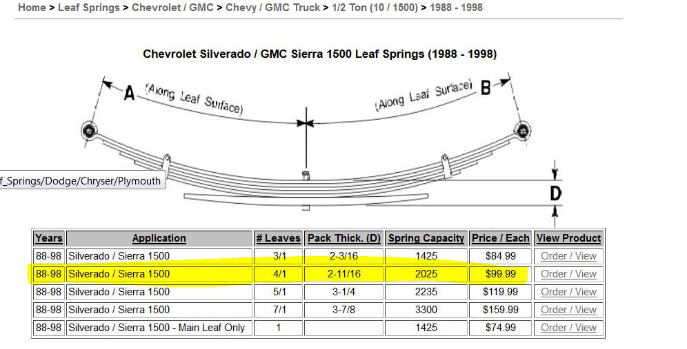

hey thanks for quick reply.
Found a website, and it revealed I have the smallest available version on my mixed breed half ton.
It was facts that went with the sale as well.. it would have been easier to make this a 3/4 ton upon the order almost 20 years ago.
long strange path it left...all factory.
Not sure why the tiny springs on the heavy weight. They have oxide marks on every leaf front and back of the stack, that is how active they are. No offroad.
this truck broke all cross sills, a tire hanger, front sway, 6 cab mounts..and they kept driving with a perfect dealer record. They stopped servicing when they realized the steel.
the first upgrade is 700 pounds of strength gained...yet still a half ton. that sure fits a sweet spot to me, I am the welder of my truck...felt the steel out, densifying etc.

maintaining flex, came up with a choice already.
not even expensive.
