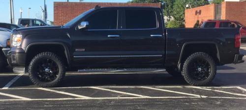

I only rub in reverse, full lock to the right. That's it, no other rubbing or trimming done. My only off road is the beach though, but have no problems on the beach
275 65
Only rubbed in reverse at full lock. Not even enough to mess with
Where about did they rub? I'm assuming lower valence? I'm worried about messing up my painted valence.
Also good to see you clear the mud flaps, I'm running the same thing. Notice any increase in rock throwing at the sides?

It rubs on the upper control arm. If you have steel upper control arms, it may not rub.
And 275 is stock width, it shouldn't throw rocks down the side. My MT's don't throw rocks down the side, but I do get more water spray on wet roads now

They rubbed on the inner fender well. No, the mud flaps caught the rocks. But really the tires hold more then they throw

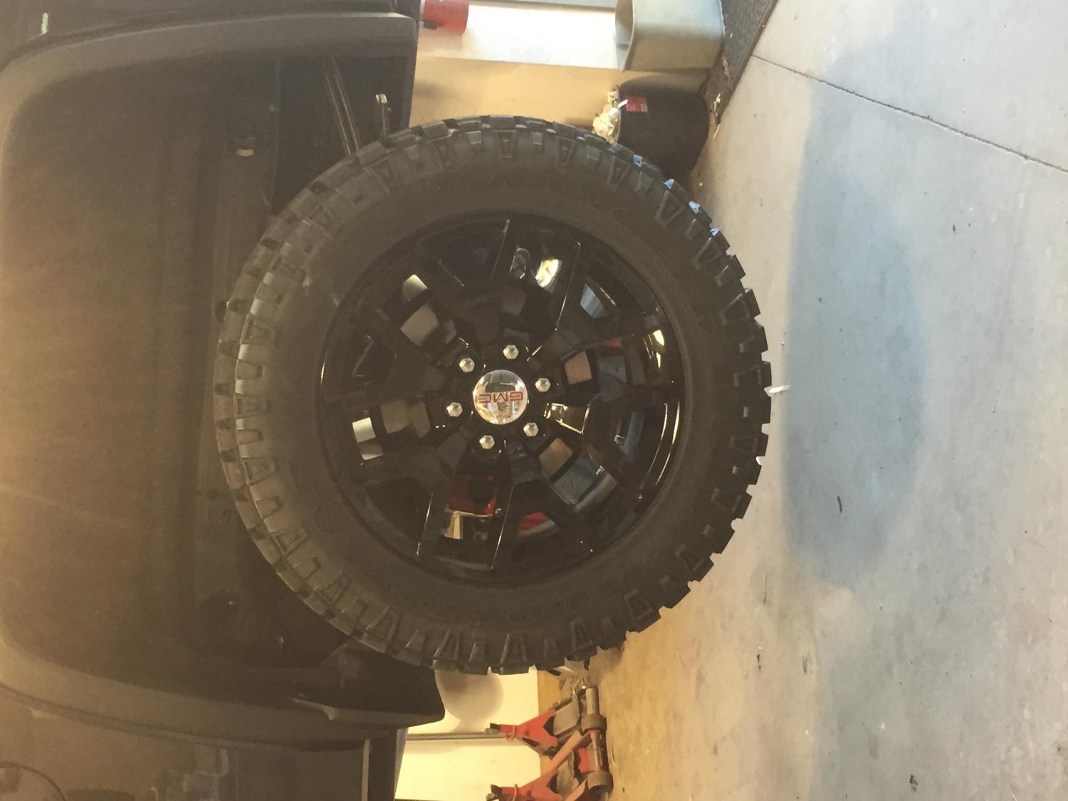

285/60 20 Dura Tracs with 2.25" Readylift and 3" block in the rear. Guys that did the install pinned the wheel well back on one side. No other rubbing issues. The tires are stout and do stiffen the ride but look great
b3e978d952d6c3b616cd673207461813_zpseee7
5c55b06787459a253d2c91530ae0e827_zps36ee
