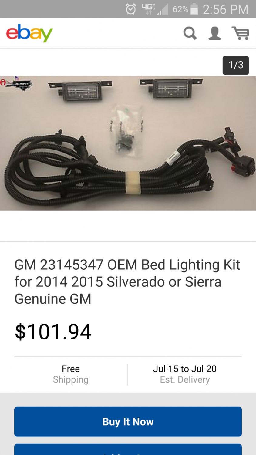

Anybody out there install another set of the factory bed lighting to there factory bed lighting? If so did you tap into the orginal harness?
To answer your question, yes. I just tapped into the first set and cut the wires so there was not a sag in the wires. I did solder and shrink wrap the wires... No issues.
Second set is up towards the front of the bed, and you will have to drill your own mounting holes... Drill holes, measure the wires and cut, splice and shrink wrap...

yep. I clicked the link that crewl1 posted and seen what you did.. thanks for all those pics. Great work. Any issues since the install?
I have 2 sets and probably the #1 thing my buddies complement about the features on the new trucks. Haven't had any issues, even with getting the Linex done.

They're not "bulbs" per se, they are LEDs - meaning that they don't pug in like a normal bulb. And after adding two more as in the picture above (OEM kit comes with two, added two more from second set) it is plenty bright enough. I have a tonneau cover and Bedrug and I get complements all the time about how bright and nice it is...
Having said that, there are those members who have used other kits with longer LED strips, whose installation is brighter. Thing is, once you get the harness, you can use whatever LED you want. I like the OEM lights myself.
