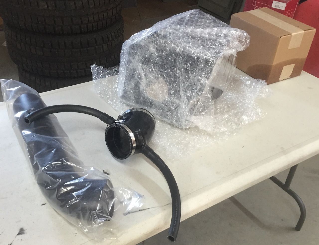

Packaging was excellent and everything you'd expect from a company with their reputation. Plenty of bubble wrap around all the pieces and the plexi-glass still had the protective paper over it that I had to peel off.

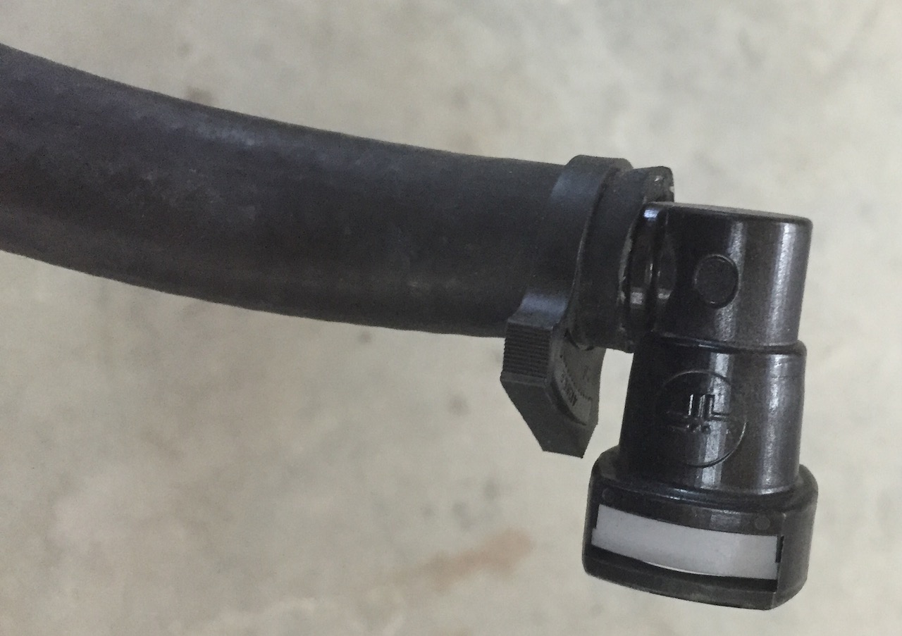

There is only one thing I am slightly displeased with. As mentioned, I previously had the Airaid Jr. kit installed while I waited for production of the CAI. The Airaid included new, OEM type, fittings for the two hoses connecting to the manifold. The CAI included no connectors and no clamps. The instructions show to simply slide the hoses on to the connector, no clamp or any other means of holding them on. Maybe they aren't necessary, but for the comparison in costs it would seem to me that if Airaid could provide something the CAI should have as well.

Here is one of the connectors that was supplied by Airaid

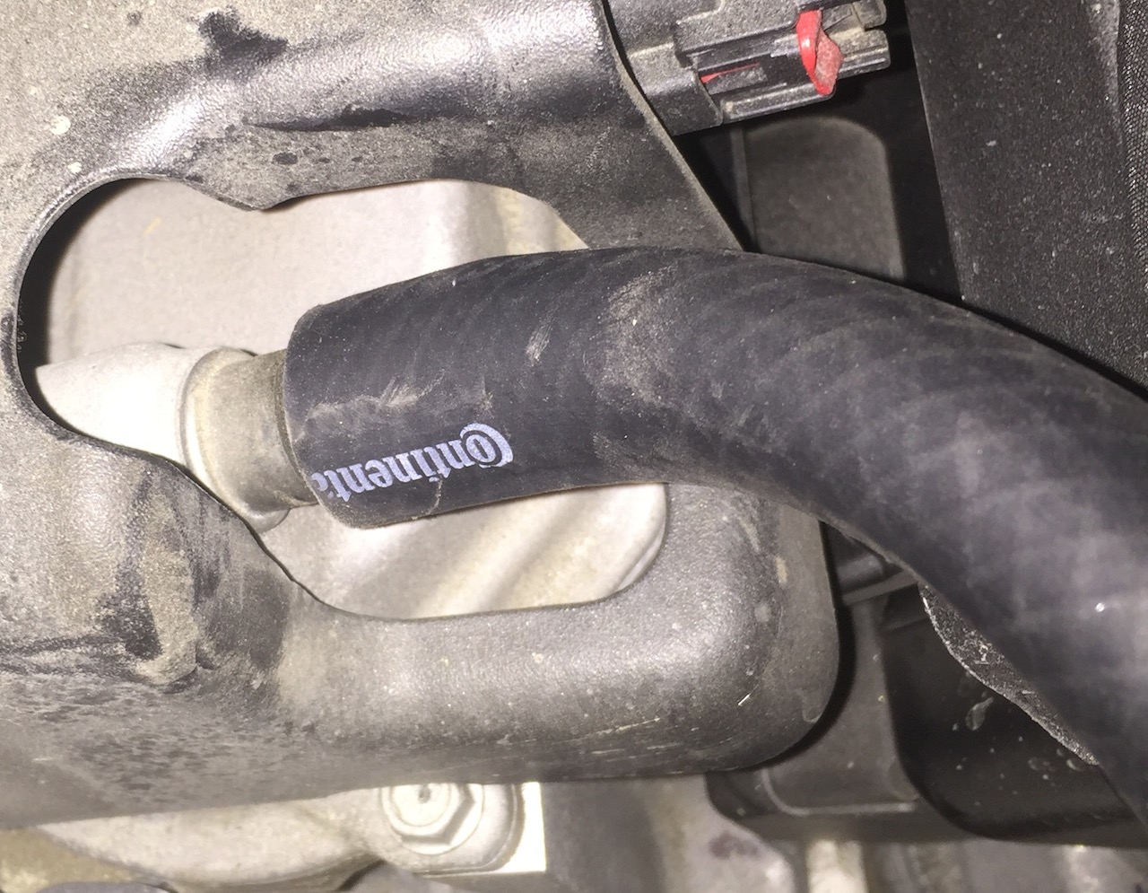

How about the other side of those two connectors in front TB? Any worry there of coming apart or leaking? Push on as well?

That bottom picture is what Airraid sends with their kit and what OP had before. It's an OEM connector with quick disconnect clamps on a rubber hose. Much nicer way to reconnect those lines then just pushing on rubber hose like Cold Air Inductions wants you to do it appears.

Just got off the phone with Martin from Cold Air Inductions. Very nice guy to talk with, we chit chatted about the truck and modifications for a few minutes. He informed me that the two hoses are under no pressure and there is no need for a connector or fitting. He said if I wanted peace of mind I could put two hose clamps on them which I may do.
In regards to where the two hoses connect to the intake piping: I should have mentioned that they came already attached with what looks like some heat tubing over the connection (I will try to take a picture later today), but it is VERY sturdy and I have no worry about these coming loose.
