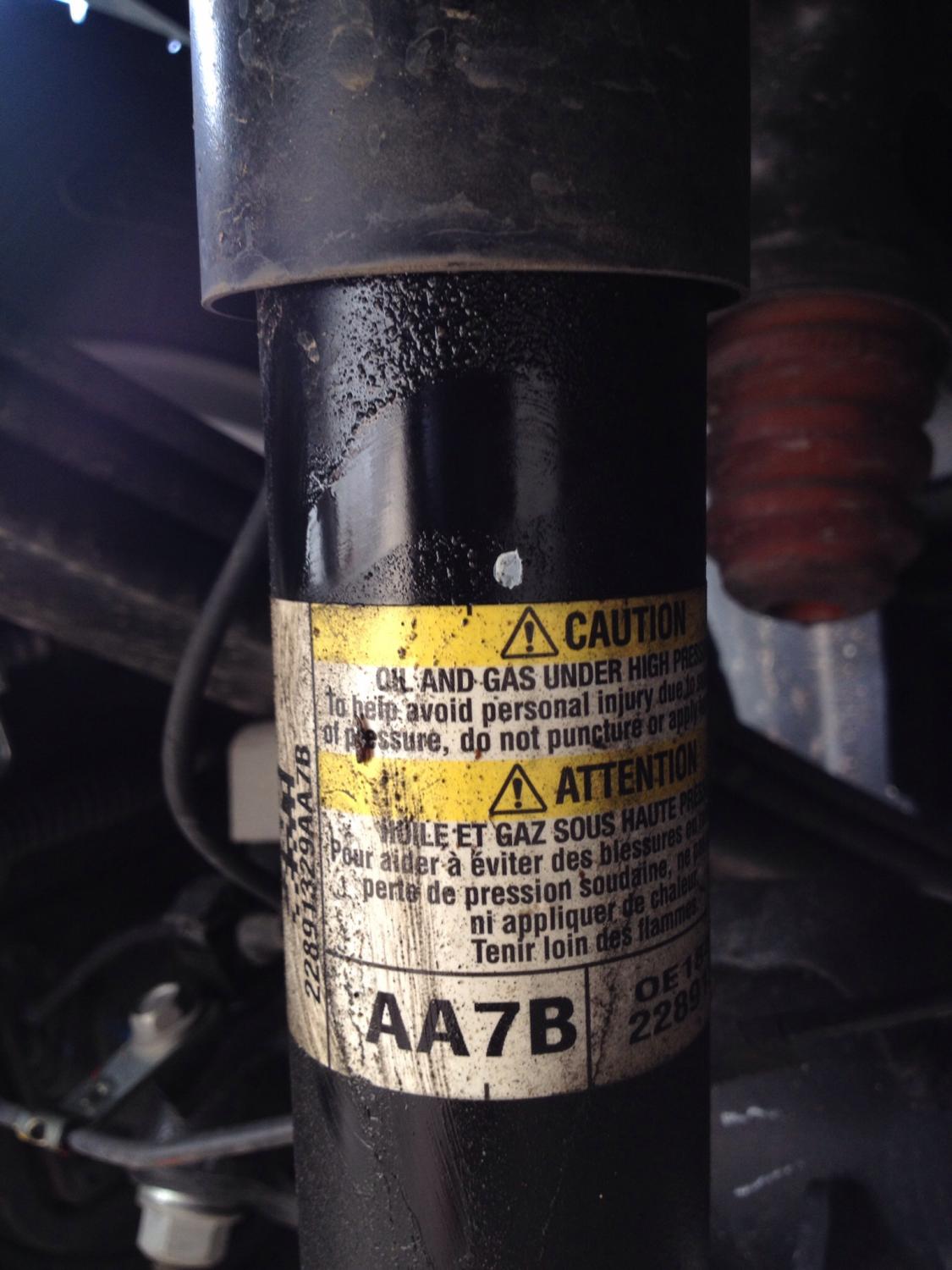

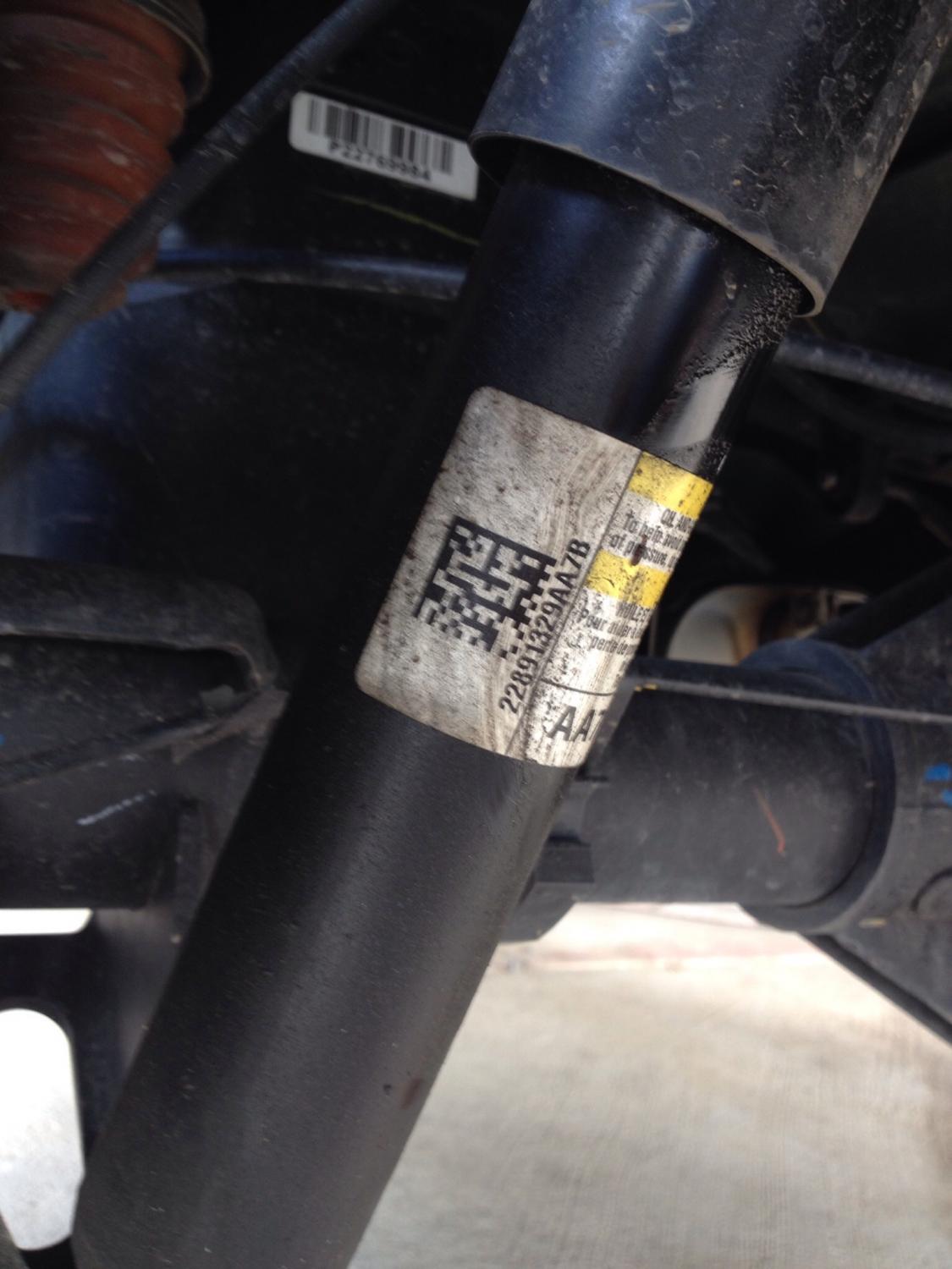

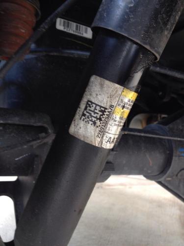

I got a chance to look under truck today. Looks like rear shocks are busted. Got pics to show.
Remember that I took it to the dealer I purchased from for an inspection.
Well they missed the fact that my shocks are leaking.
I was reading about tennecoshocks and thier history just the other day. Well I hate the American product on my truck blewout first.
Gonna send GM a bill for my time and my labor. Gonna put another shock set on even through these are warrantied. Gonna drive by and show my local dealer. It's The local dealer that wanted me to wait til 5k. Crazy eh?
Maybe I can sell the other shocks or donate them.

Just installed bilsteins on all four corners. Have nice responsive ride now. It turns out one the rear shocks was blown not both of them. So might been fine with just replacing 2 new rears. But what is done is done. Truck feels stout and sharp in response with less roll in cornering. I think the oem shocks are super cushy just a little light weight and easy to damage. Next mod, I might try a multi leaf expedition springs from atlas.
