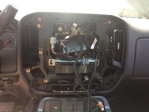

Everything out ready to install HU
Had to take glove box apart to get to camera plug

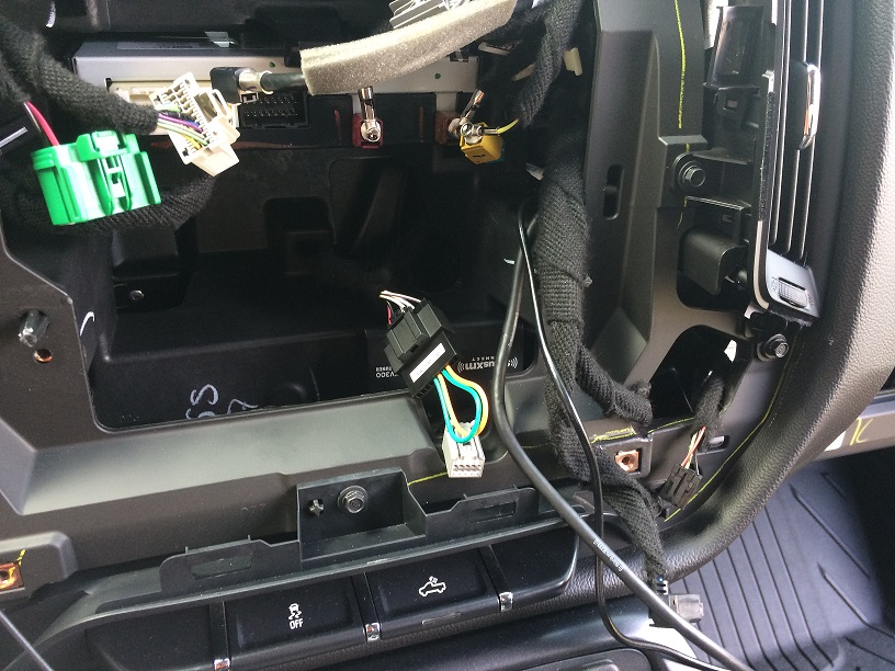

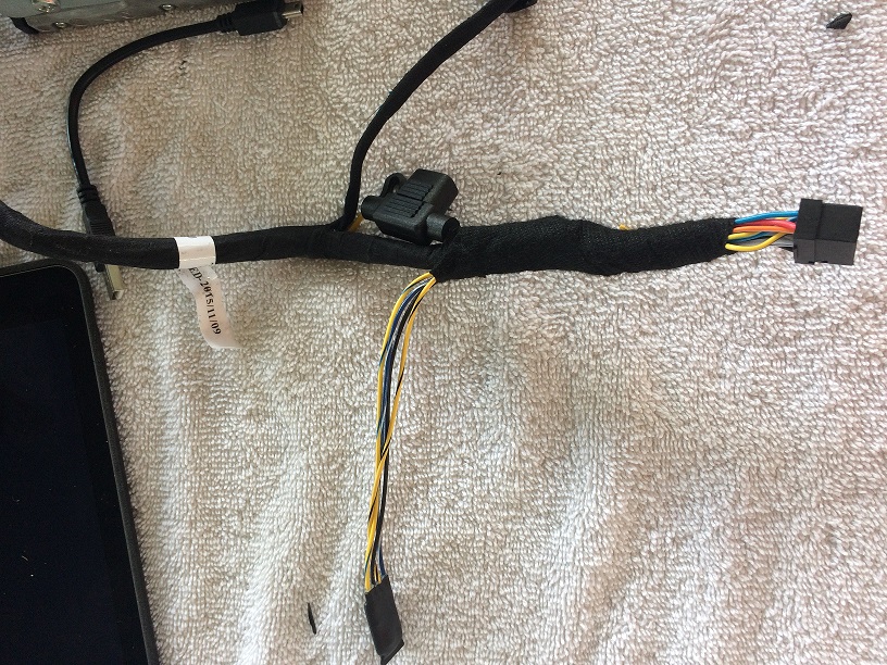

Harness modified for bypass
10 pin bose jumper and SXM module installed

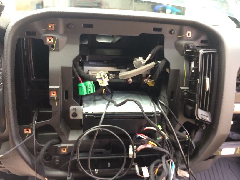

DVD player in, harness connected
Everything packed in

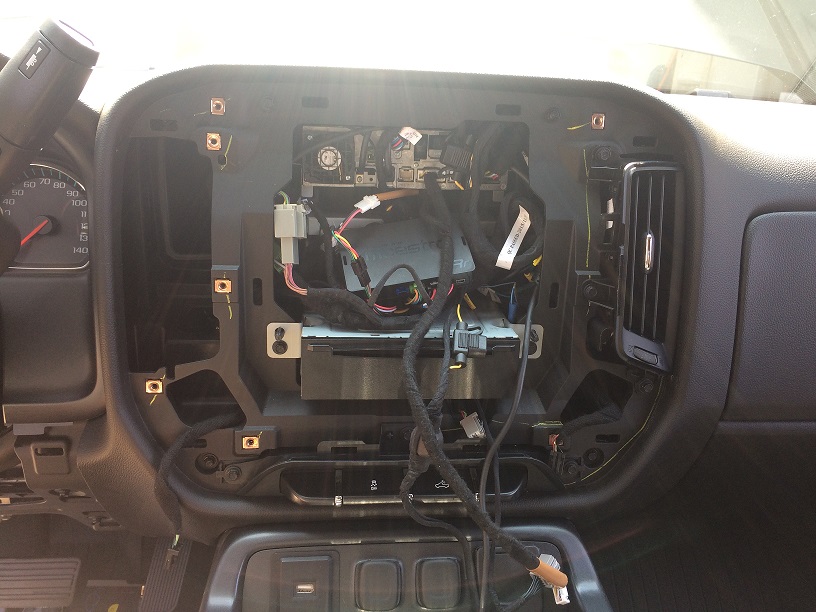

HU at top, idata maestro module in

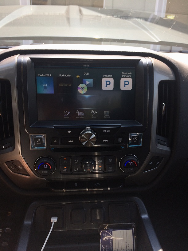

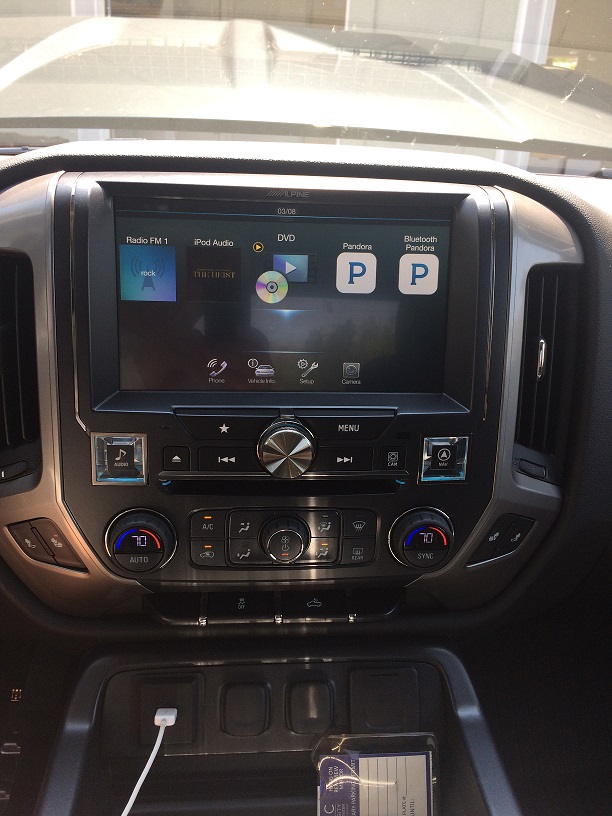

Finished and powered up
Sorry about the size of the pics, I had to reduce the size in order to post them
Initial thoughts:
Remarkably better than factory HU
Really looks like it came straight from the factory
Everything works including chimes
Dash/Gauges view screen works except for audio of course and the phone says off
Info screen works the same and navigation has a compass only
Onstar still works as well as phone BT and microphone
Only draw back is I had 3 USB plugs and I had to go down to one
Plan to change the one USB outlet in the center console to the glove box or center box and put the dual USB outlet back in the center console. They all will still have power, just won't connect to the HU
Blue square audio an navigation buttons are a little cheap looking and the knob could be sturdier
Otherwise sound is better and there are more tuning options available
SXM sounds better, I know crazy and it hasn't dropped out once
Plan to run some power wire and start on adding a sub
Looked under center console tray, I have a sub, may try to put an 8 in there.
