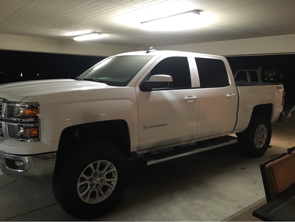

Just installed today so can't say much.
Nice! What size tires are you running? Which kit?
Looks good!

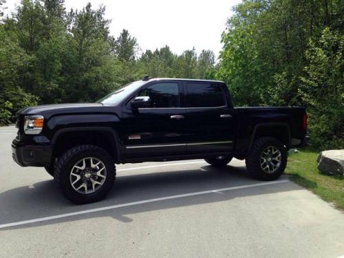

I have RCX 6". I can agree that shocks suck, I plan to get a set of bilsteins all around or fox.
I'll also say that it's better to try and find a different set of blocks for the rear and do trac bars. This isn't to say the ride is bad but since it's 6" tall, the rear block has to be wide, and so you have to tighten down the rear leafs a far amount which leads to a hard ride for rear passengers. This is a complaint I hear from my parents when they ride in the back seat, don't hear a word from them when upfront
Other than the ride not being great I haven't had any issues. I've had it for 10K miles and don't see any rust
Zone 4.5 and tires are bf 35x12.5x18
Also did you do any trimming or have any rubbing with 35s?
