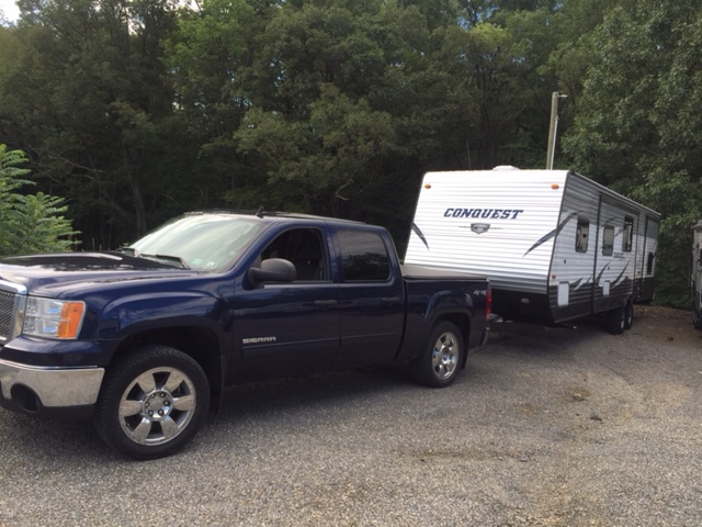

Hello all, I have a 2009 GMC Sierra 1500, quad cab 4x4 with a 5.3L 6 speed tranny & tow package. The truck is rated for towing 9500 lbs. I have been towing a camper for a few years that was around 6000 lbs, which it did pretty well at. I have now upgraded my camper to around 7800 lbs and it still does pretty well all things considered, using a Reese weight distribution hitch with cam bars for sway control. My question is I would like to give the truck a little help with cooling and add a little more stability. Can anyone recommend an auxiliary transmission cooler w/ fan and oil cooler? She heats up a bit pulling long hills and stop/go- transmission around 235ish. I am also thinking maybe a leaf helper spring to stiffen the suspension a bit? Parts lists or kits suggestions would be great.
I know I'm not going to win any races, I take my time, and yes I know this is a lot of weight for this truck. I don't drive it all over the country, just trying to give my 1500 a little help and keep temperatures in check a little easier. Any suggestions & comments welcome. I have attached a pic for your viewing pleasure. THANK YOU!!
