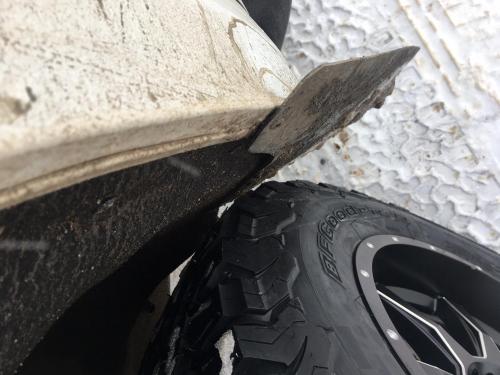

This is litte late but for future readers, 2inch level will not work! Regadless what you read. I have 285/65r20 bfg ko2s and 3.5inch lift front and back and the just pass the mudflap maybe 3 mm if that. You need a 4 inch or more to safe with no trimming. I havnt trimmed yet but if your off road you will have to. Its closest at 3/4 cranked. Then full crank you gain more room again. This is for a 20x9 rim with 0 offset. I wass dieing for a week straight wondering if these would fit so hears your guys answers! Cheers!

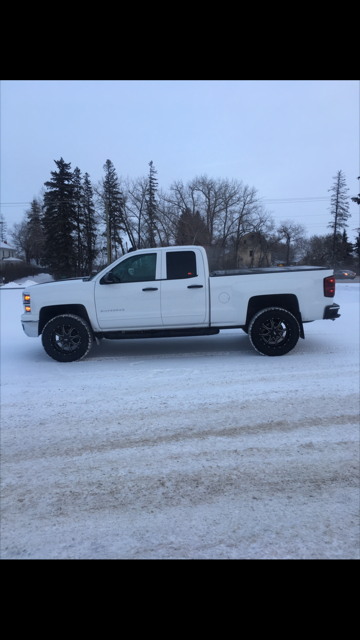

I am currently running 285/65/20 KO2 on my leveled silverado. Minor rubbing at full lock.
I know this is late but I’m looking at the same exact tires atm for my 2018 4x2 Silverado with a 2.5 RC leveling kit and rear block. This should fit mine as we with minor rubbing at worst correct??
