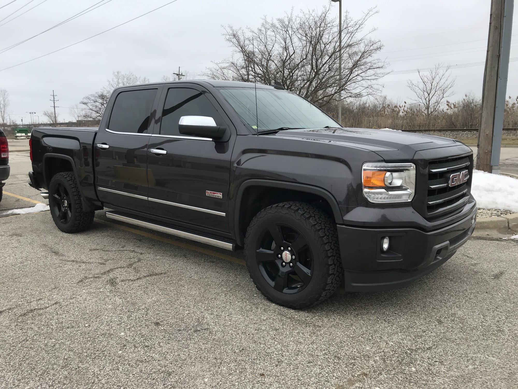

I was able to get these installed on a 2015 Sierra Crew Cab. Unfortunately the wiring is different as these were not an option for 14-15. I don’t have the wiring required for (GM LAN and running board disable ) ran from the running board module. I previously had the amp research boards but didn’t love the look of them over these. I was able to tap the motor wires on the boards to make them open and close similar to the amp boards would. As of now they open and close fully extended to the bed, I am going to modify the rubber bump stops on the boards  so I can get the them to stop at cab length. Personally I don’t care if the rear extend mode works or not right now. I figured I would wire these so they are usable on a 14-15 and then if I decide to buy a 16+ I will be able to use the method above.
