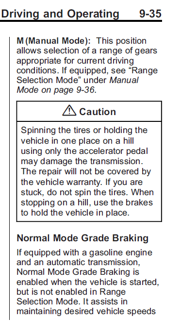

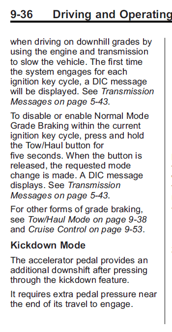

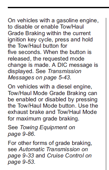

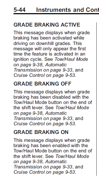

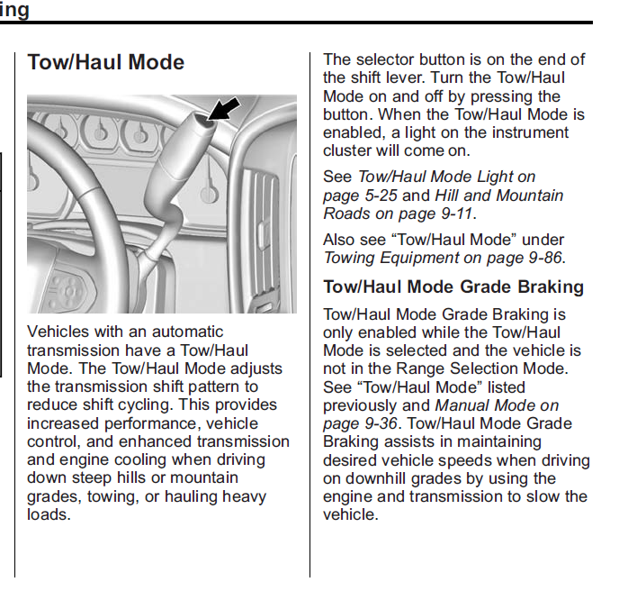

Still trying to make sense of it myself, but looks like the message is only displayed once and there are two different forms of Grade Braking.
post-152266-0-93895900-1453265589_thumb.pngpost-152266-0-88211900-1453265603_thumb.png
post-152266-0-13139700-1453265622_thumb.pngpost-152266-0-57420800-1453265635_thumb.png
