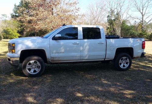

305/65r18's on a 2" level and 1.5" body
retodd709
It's almost time for new rubber...anyone running this or have any opinions on fitment?

I'm running that size in the bf goodrich ko2 with that set no rubbing what so ever on stock wheels

It looks to have plenty of room for flexing as well. I wouldn't push it to a bigger size personally but I have had no issues with rubbing at all under any circumstance.
