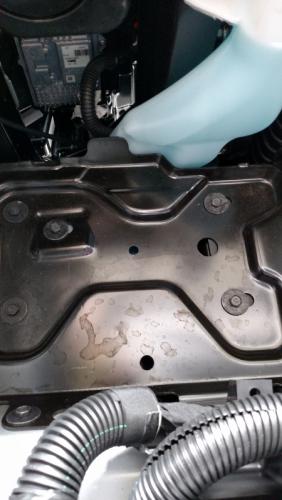

Am I missing something with the new 2016 trucks and the aux battery tray? There seems to be a different hold down system than my 2008. I don't see the nut for the rubber/plastic block to thread in or the grabbing "lips" or whatever they're called that pinch the other side of the battery in when you tighten the block. Do I have to buy a separate tray or what?

Sir Dan did you ever find out how to tie down your second battery, I also noticed that my 2016 doesn't have a threaded nut anywhere for the rubber hold down. Didn't know if this was different in the 2016's or not.
Have a look at a new Duramax and see how GM is doing it now. (all Dmax's have dual batteries)
Did you ever figure this out? I went to install my 2nd battery tonight and ran into the same problem.
I just gave up on the dual batts for now. There is no GM made battery tray that will fit into that area on the newer trucks, Its only there to support the engine computer. Some guys have improvised and modified trays that work fine. Lots of posts out there.
