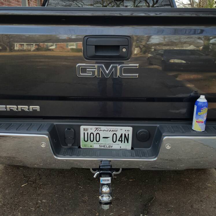

Just finished! I had two spots to touch up with toothpick. How do I post pictures without tapatalk rotating them sideways?

Looks good!
