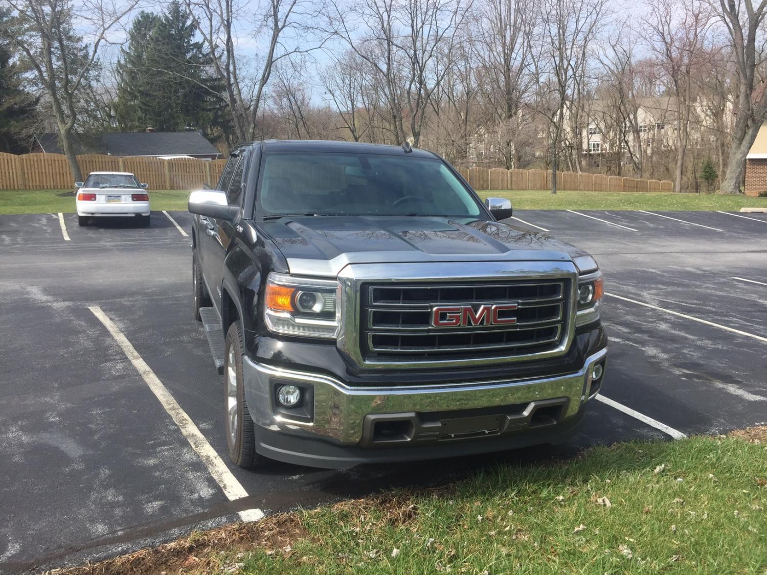

Alright fella's new user with a new truck. I just posted an introduction in the new member forum FWIW. Any who... just picked up a lightly used 2014 Sierra SLT dbl cab and can't wait to get my hands dirty making it my own.
This is not my first GMC full-size, but it is the first one I really plan on modding out. So without further ado I'll share my road map for customizing the beast. (This will be a slow process as I have an extremely demanding job at which I put in a ton of overtime, all to help pay for the truck mod :drool:)

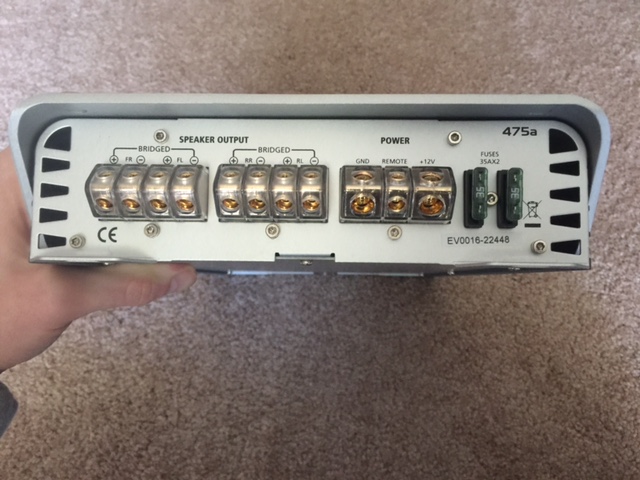

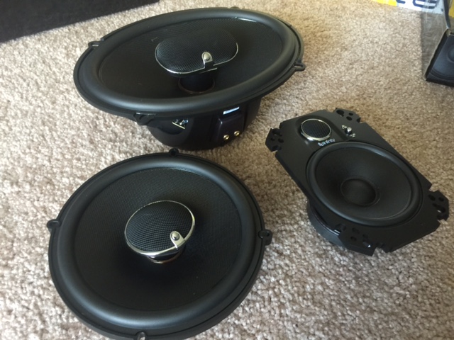

My plan is replace the front factory door speakers with Infinity Kappa 693.11i 6x9s, the rear doors with Infinity Kappa 62.11i (left over from a planned but never completed mod to my '06 Sierra), and put Kappa 462.11cfp 4x6 plate speakers under the dash if I can find a creative way to mount them. My plan is to power the doors off of a Infinity reference 475a 4-channel amp left over from the uncompleted 06 Sierra mod, which will be fed by by the factory head unit using an AudioControl LC7i (which I'm hoping will fit above the CD player).

The goodies are starting to come in. I will likely have to amend the subwoofers going under the rear seats though. Likely end up with Alpine SWT-10s2 wired down to 1ohm hooked up to the pioneer GM-D 8601 I have on order.

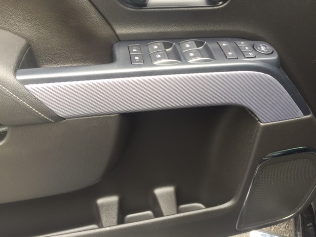

well t's been a while while since i had the opportunity to update the build thread mostly due to the fact that i was pinned down at work, and then got into the mods neck deep. but since the project is mostly done, its time to display the work. While I was waiting for all the sound equipment to come in, I started a vinyl wrap to cover up the faux wood which I thought was really ugly. Used the 3M 1080 Anthracite carbon fiber vinyl film. Im really happy with the way it came out. IMO it looks way better than the factory wood.
Its clearly a very high quality product and 3M did a really nice job of adding some texture to better mimic the carbon fiber. Fake carbon fiber looks really bad pretty easily but I think this is the best fake CF I've ever seen.

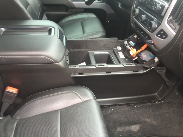

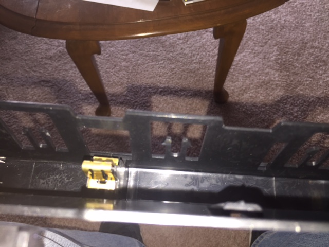

The trim pieces on the doors come off easily enough but the center console took a little while for me to figure it out. The key is to open the armrest, remove the cup holder and get your finger between a strip of rubber moulding and the top section and pull straight up and the whole piece will start to unclip. Then the faux wood trim can be slipped off (some clips that are integrated to the upper console get squeezed to release the trim. I think the below pics are out of order.

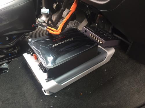

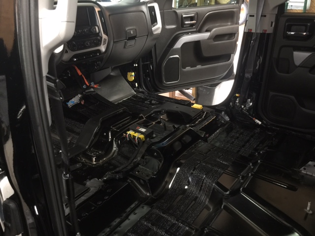

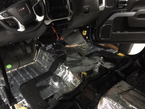

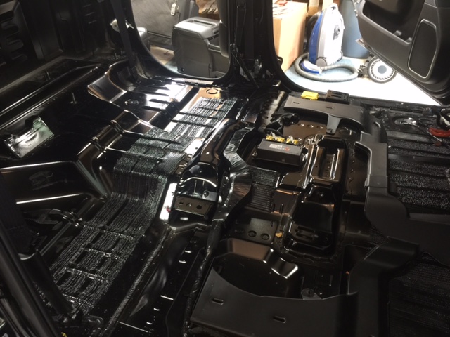

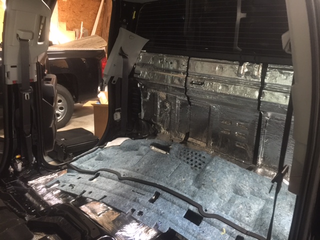

With the trim work finished, I started on the audio mods. First i pulled the center console to ensure my plan to fit the amps under it would work. Which it did. Special thanks to OBrien19 for the help on measuring the console so i had an idea if it would work before I pulled mine. With the console out, I stripped the rest of the interior down to the sheet metal to install Noico Mat. Same thing as DynaMat without the name. I did everything from the windows down in 80mil mat. I ordered the 72q ft kit for $120 from Ebay, and had about 4 ½ of the 18 sheets left over. Maybe ill put it somewhere else.
I was concerned about if i notice a difference with the noico mat considering the truck was already so quiet but I definitely did. Totally worth the work in my opinion. My other concern was cooling for the amps in such a constricted compartment. So far no issues but Ill continue to monitor. If it does become a problem, ill cut the bottom of the deepest bin out and make a false floor with some cooling fans, in this case the tight space should actually help as it will create a wind tunnel effect around the amps.

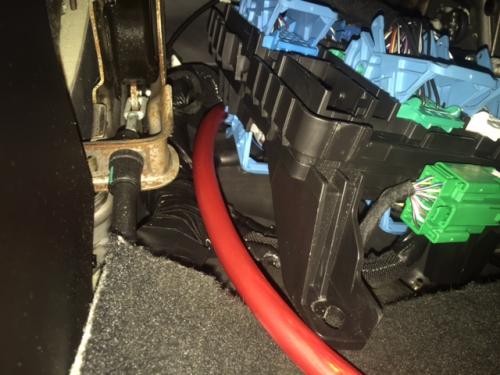

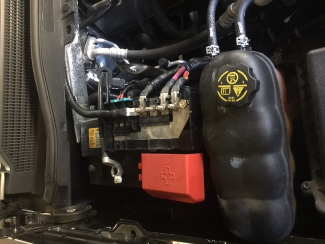

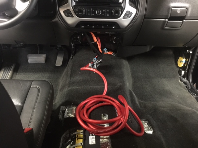

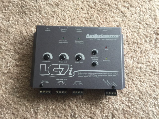

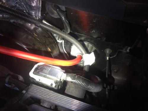

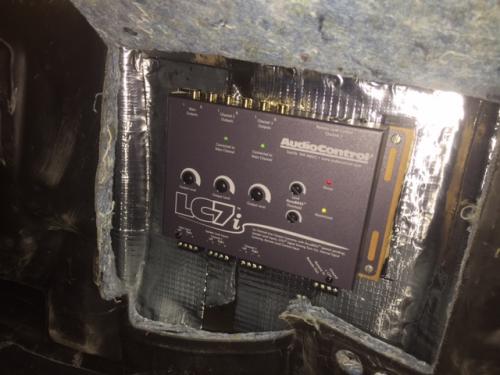

As the build progressed it started taking so long i slacked on pictures. :nonod: Sorry... Anyway i Ran 0 gauge wire through the fire wall at the common location to a 0-4 gauge distribution block, and a 14 gauge wire to the LC7i which i unfortunately had to mount on the rear wall (where the actuator for the sliding rear window would have been if it was installed (actually the cut out for it in the sound deadener provided a nice access panel.) I made to wood stand offs which i glued to the truck (same with the amp racks) so I didn't have to make any holes in the sheet metal. I made a t harness with the metra harnesses and ended up rewiring all the sound output from the amps in 14 gauge speaker wire.
The LC7i Line out converter is really nice because it has a signal sense remote on, with a remote out which save me having to find a 12v turn on, and running an extra remote wire. Below are the amp rack.

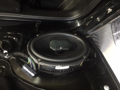

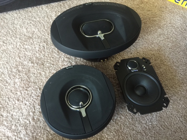

I failed to realize the lack of mounting depth on the front doors. In a pinch i tried to make a mounting bracket out to the old 6x9 which worked but i didn't trust it so I ended up replacing it with aftermarket, purpose made brackets.
