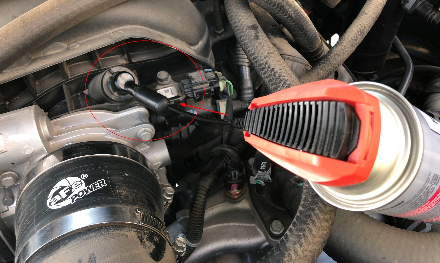

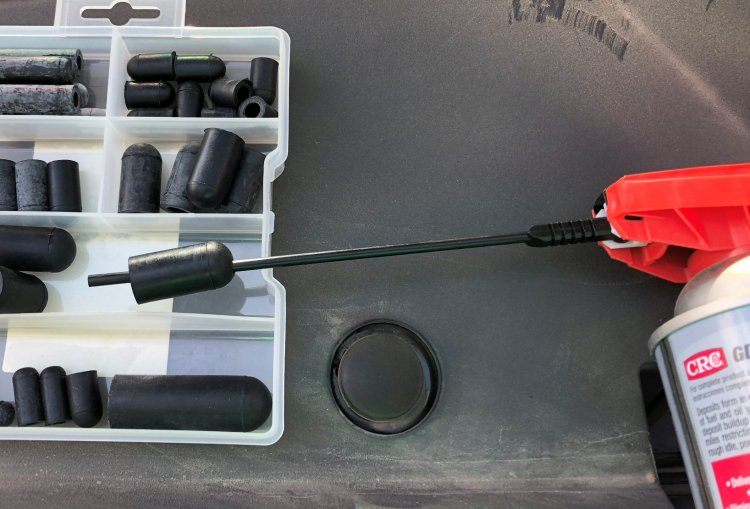

I just did mine today using the vacuum connection above the TB. Took a rubber vacuum plug and put a small hole then pushed the tube thru it and hen slid in on over the fitting ...no vacuum leaks or CEL to deal with. Ran in about 3/4 can @ 2K then shut it off to sit awhile. Th CC is pulling out a lot of crud but i put it on ~10K.
