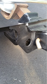

It just seems like a odd set up nothing like the old one i had on the 2008 gmc 2500. anyone have pics of their setup?
Obviously on a 1500 but same scenario
