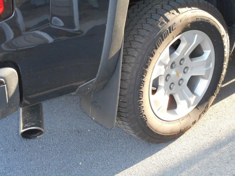

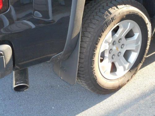

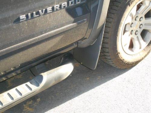

I'm saying it can't, unless you cut away the outer edge of the molded guards and then it will look like crap. I found out the hard way the molded ones do not fit properly over the flares because the outer edges of the molded ones do not wrap around the flares leaving gaps and sit cockeyed. I exchanged for the OEM flat ones which do fit.....they come with rivnuts, but the rivnuts are not needed .......they mount and sit firmly because of the extra thickness of the flares.
Rears were not so important, but the fronts were necessary to protect the steps from stone chips. The molded ones are black, but the flat ones are anthracite that matches the color of the flares.
Thanks for the pics. Looks like the flat ones will work just fine.
