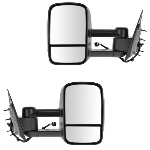

So, I'm in search of tow mirrors for my '16 Silverado 1500. I'm too cheap (aka- the wife won't let me) to spend $600+ on the newest OEM style. I had just about convinced myself to get some of this style....large.JPG
But today, I was checking ebay, and I found these:
http://www.ebay.com/itm/07-13-Silverado-Towing-Power-Heated-Chrome-Mirrors-LED-Signal-Clearance-Lamps-/161890536480?hash=item25b16d8c20:g:8YcAAOSwkZhWS96r&vxp=mtr
They say they're for older trucks, but they're the newer style? I know everyone is sick of this question, but.... will these work on my truck? Any thoughts would be appreciated.

I bought these for my truck, not to thrilled and would like to go to the newer style OEM. I ran a wire directly to the new mirror thats a key on 12v for the clearance lights. My understanding is the new style are being made for a lot of the older trucks so the ones for the 13 may not fit, I just don't understand the price difference, why does it double between 13 to 14 and up.
per this listing they are newer style (15+) but made to fit 07-13 meaning they only have 3 threaded studs and our trucks require the 4. I believe the HD in 14+ retained the old body style mounting. I would say. No these will not work
Those will not even mount to the door. Whole different truck 2007-2013 vs. 2014+. Those have the 2007-2013 door mounts on them for 2007-2013 doors.
My truck (2014 1500) has 3 studs, I would have to drill the hole for the 4th on the OEM mirrors. And like I said I could figure out the wiring, it's whether or not they would mount to the door and blend with the molding for a clean install is what I would be worried about.
I don't believe they do, they are different mounting "plates" they require the 4th hole and the pigtail is different as well.
