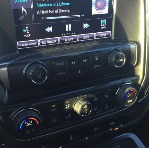

On 5/27/2018 at 9:44 PM, Viktorrocks15 said:
Alright, so it’s been a long time since a wrote in this topic, but later I found out that the auto does work., my truck didn’t come with the dual zone control and after installing the one with the dual, realize what a lot of people have done after me., installing regardless if it doesn’t work. But as I said the auto does work on my truck when turn the fan off and press the auto it comes on and turn gradually as it gets to the temperature set., now I’m on the quest of continue with this upgrade. After doing a full 16 front conversion, adding the ac/heat oem leather seats to my cloth heated seats, fully unlock my HMI adding the flip down screen and having it fully functioning as factory thanks to @pgamboa and @GTPprix. I believe that the only module requires to program is the HVac module., after obviously added the required harness, sensors and etc. I have successfully swap my non leather dashboard to a HC leather dashboard and taking apart the whole dashboard I feel confident that this might doable. The real failure will be not to try. So I’m going to take my time on this one and after @GTPprix is not as busy as he’s now I might send him my module to program it. If thats an option.lol.
Victor,
Wondering if you ever got the entire thing working?  I am very interested in doing the conversion .  I want to get the auto climate control to work but I dont need the dual climate function, just single to work.     I am thinking many of the innerds of the system need to be changed to get the DUAL climate to work, but maybe if I care only about a single climate control only a couple of other items need changing
Control module 13591693 perhaps?
BTW, I also get the 'auto' button to work.   Just as you described, if you turn the HVAC unit completely off by pushing the fan button then click on the 'auto' button it does turn it on in auto mode.  Does not seem to control the fan speed  100% correctly but its real close to working correctly. Temp seems to be controlled ok.    And it switches from Dash air for cold to bottom air for heat which is what it should be doing.  damn close!
I am going to try the inner control module 13591693 as I describe above which is the one for the auto temp control.   It might just be what is needed.  I'll report back.   What I dont know is where this module is located!   If anyone knows, please let me know.

On 7/25/2018 at 6:15 PM, Levahj said:
Victor,
Did switching the inner control module work for you?  I just want to be able to control the fan speed manually as well as the temperature.

So I have been following and thinking about doing this for a while and I think I'm gonna try something slightly different by taking the control out of a canyon/Colorado since they have single zone auto. I can get a new controller for like $90 so I'm thinking about pulling the trigger on that, if nothing else it'll look nicer than the base.

So I just got the dual ac module for my 2017 Silverado regular cab WT and currently experiencing the same issues as stated about saying that the auto doesn’t work and dual control either and I expected this but I at least wanted the passenger one to be synced so both numbers could be the same when I adjust the driver side nobe(it is currently stuck on 72) so do you think if I were to find someone with a dual climate control system and plug mine in and set it on sync it will stay like that when I move it back to mine? Mine also does not blow to max with this new module, it only goes to the one before max.
