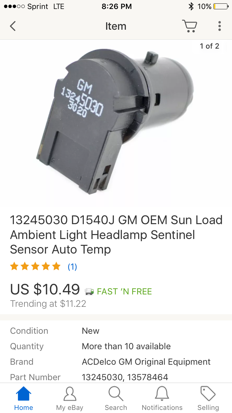

Still trying to figure out how to post pictures from my phone going back and forth from the mobile to full version, so I purchased the sensor I only need to buy the unit with dual zone, does the part I added looks right to you? Questions and comments are welcome.
Yup, thats the same part # I bought online. My dealer is going to install and test it for me next Monday, so we will see how it works
I bought the unit today, I should be getting it by the 19th, so we'll see once I get it., hopefully the automated temperature works, if not this ac unit looks 10x better that the standard one.?

They said I needed more parts than just the head unit and sensor. Oh well, that was fun.
