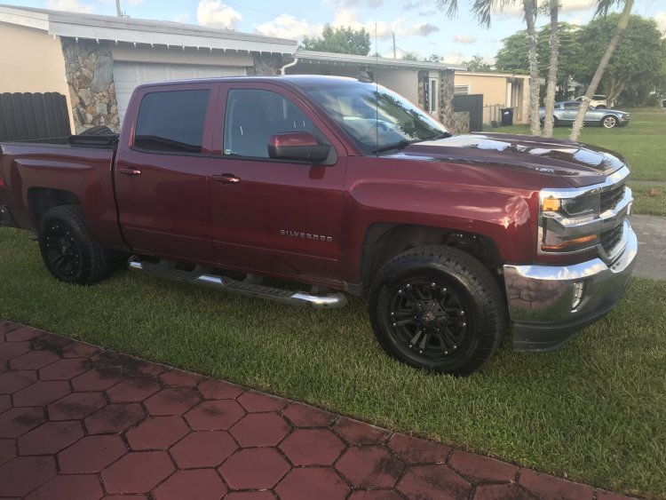

275/65/18 on 18x9 +12
860FBFA9-8EC9-4C23-ADC2-A1C04DBEB954_zps
Hey HoosierZ, would you mind sharing the brand/model detail of the wheels and tires on your setup?  Also, what level kit/suspension are you using?  Thank you.
Been running that size in Copper ATP's from day 2 when I ditched the Goodyear POS OEM tires... I'm on my 2nd set of coopers and it's a great size..
Wheels are 18x9 +12 offset Black Rhino Lucerne. They were discontinued a few years ago. Tires are 275/65/18 Mastercraft Courser AXT. The level is a set of lower spacers I made. They’re 1” thick and raised the truck 1-3/4”.
