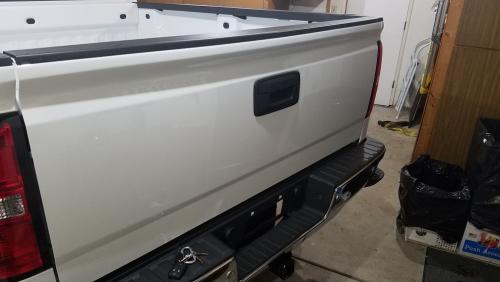

My first mod. Not a big fan of chrome so, off they went. Also, over time they get hard to clean behind the letters unless you take a toothbrush and clean them that way.
Next, is a complete wax and grease remover with a really good wax job. :D

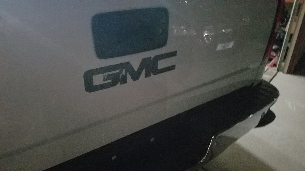

Love that clean tailgate. I have been thinking about removing that big "GMC" but I have no clue how. How did you go about removing?

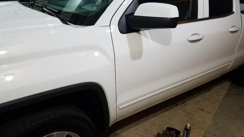

First mod I did with mine was to remove the tailgate GMC logo, then on the new truck I removed the lower chrome door trim as well.

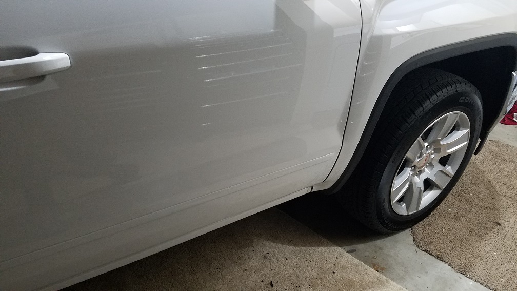

Also, you going to leave the bumper guard on the doors? I'm thinking about stripping mine.

I wish GM had continued the monochromatic scheme on the All Terrain package, I would have left mine. I just hated the chrome on the doors, looks out of place. I put color matching door handles on last week. Next up will be the mirror caps and then to black out the window trim and then all of the chrome will be gone off of my truck.
Buy 25bls. fishing line. $1.84 and walmart Cut a 3 foot section and wrap both end around a finger or hand. Leave about a 1 foot gap between each hand. Place the fishing line behind the badge and use a sawing action. Don't pull very hard, just let the line do the work. Be careful not to over heat the line or it will just break in half. If it gets stuck, back out and try again. If so, just unwind from either hand start over. I noticed if you let the line to get just warm enough it will cut the best. Do this in the sunlight or if you have a heat gun, just warm up the badge a bit. If you live in a cold region, heat it up or you will play hell trying to cut it. Now comes the fun part. The sticky sh*t left behind. I used my thumb but I would highly recommend the 3m rubber wheel. Buy 2. the Big GMC logo is huge!!!! I've done this so many times with my thumb on all my past cars and trucks and never bought the rubber wheel. It hurts after a while, All the pain is worth it. lol

The bumper guards might go. I don't know just yet. At least its white. If it was chrome, that sh*t would have been off by now. haha
I agree but I hate having to scrub the letters and you really never can clean well between the letters.
