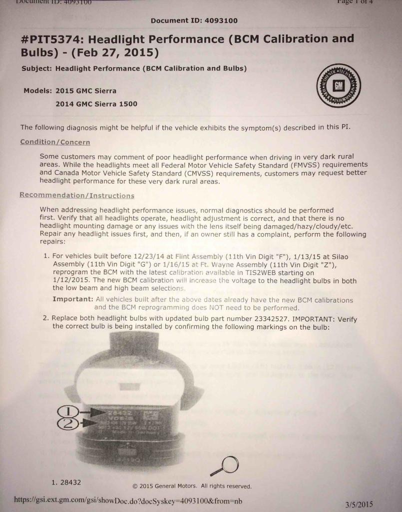

Read the Headlight Illumination Issues topic. Somewhere in there you'll find a service bulletin from GM that addresses the issue. Basically, the dealer increases the headlight voltage by reprogramming the BCM and installs new bulbs.If you want to skip the reading, just tell the dealer to find the service bulletin. Any dealer should be able to find it.

Your dealer, if competent, should be able to find the service bulletin for you. Talk to the service department, not the salesman. If it were my truck, I would want the dealer to perform the service bulletin so that the headlight voltage is increased. You might also be satisfied with the factory-approved upgraded bulbs. After that, you could modify a different bulb on your own, if you want to.

Here's a copy...
Yes, dealer has done this. Some here have installed either LED, or HID Bulbs that provided adequate lighting, all that was needed was to trim the tabs on the Bulbs.....this is the info I'm trying to find.....I just can't read thru over 100 pages without getting cross eyed.
