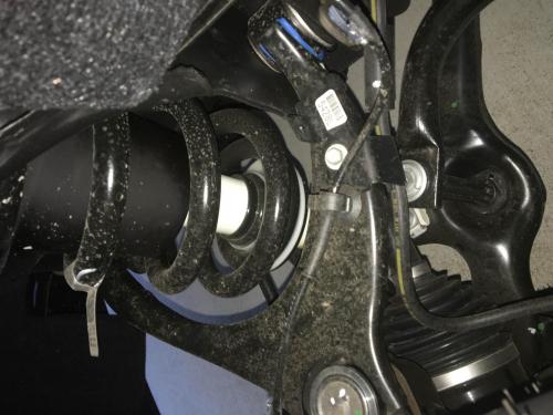

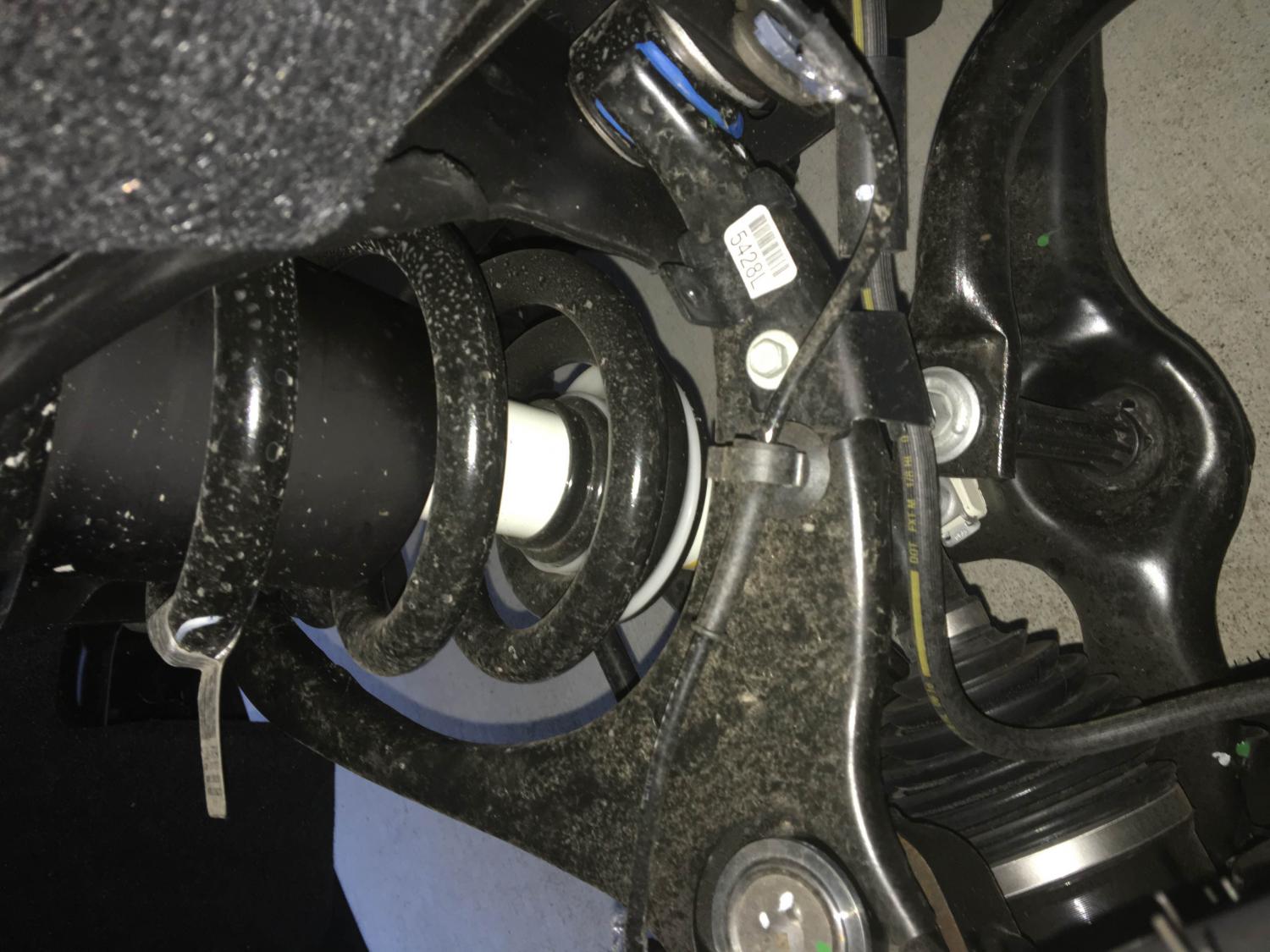

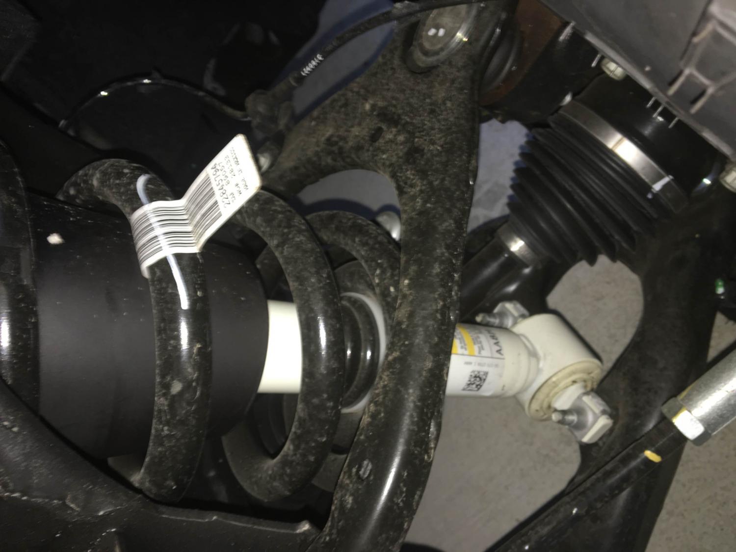

What UCA's are these? Wanting to do the RC 3.5 Lift
Meethead
Here are my UCA's on my 2016 All-Terrain. These UCA's do not look like any of these on Rough Country's website. Any help would be appreciated!

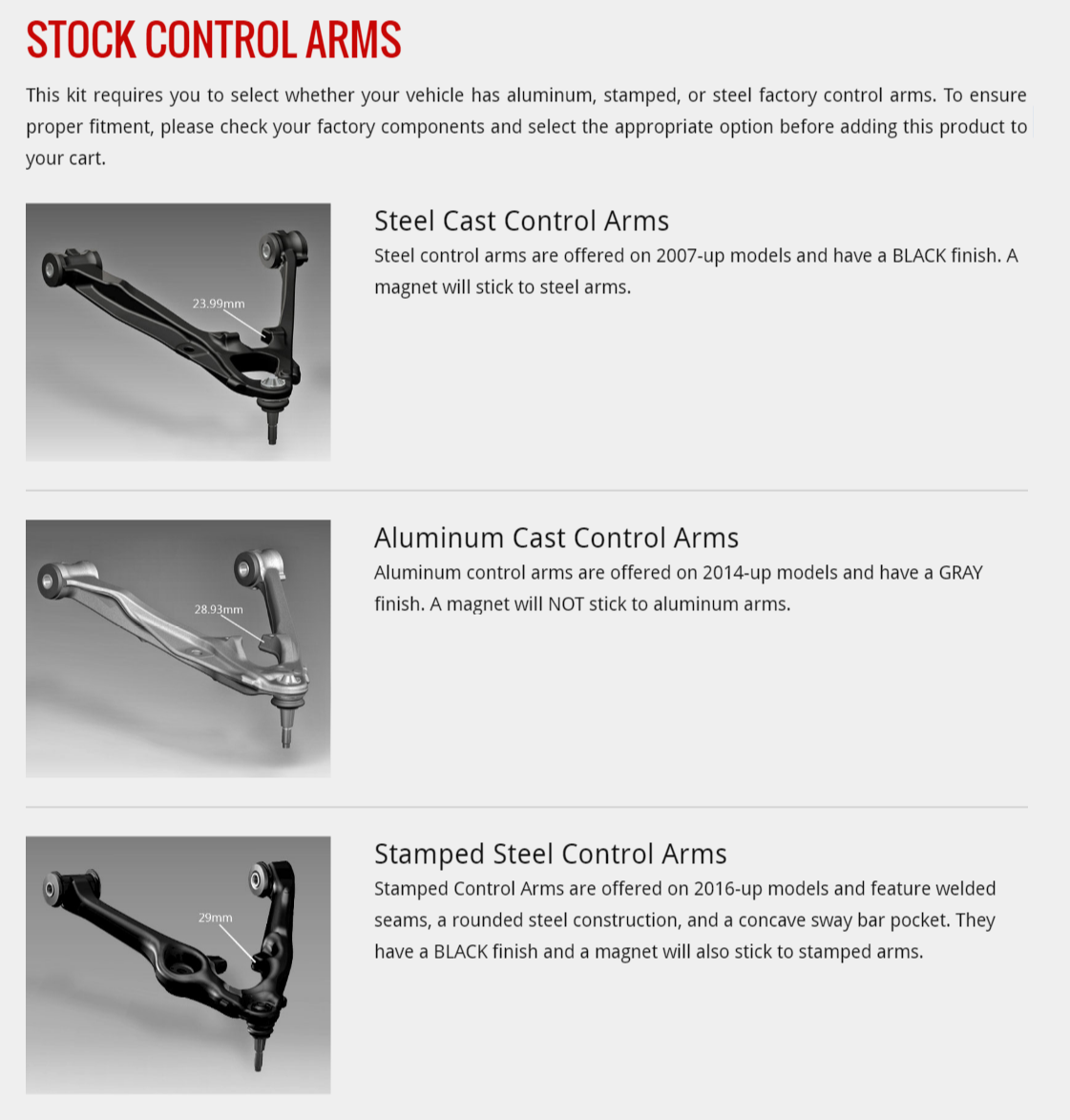

Apparently I need Cast steel.

sorry the site rotated my pictures.
Stamped steel, no doubt about it.
See how your arms are smooth and rounded at the edges
Also those example pictures you have from rough country are pictures of the lower control arm but the arm itself is upside down. The balljoint stud in those example pics should be point up.
Thanks mate! so Is the rough country 3.5" lift out of the question since I have stamped steel and not cast steel?
According to Rough Countries website you are out of luck with the 3.5" kits. The 2in and 2.5in level kits have the stamped steel option and the bigger 5in" kits do as well.
I'm sure if you wait a little while Rough Country will update the 3.5" kit for the stamped steel options, your truck is new so it takes time to take new model year suspension changes into effect.
Last month I was looking at getting the 2.5 kit and they didn't make it for the stamped steel arms. Looks like they just updated it for the stamped arms with different spacers.
