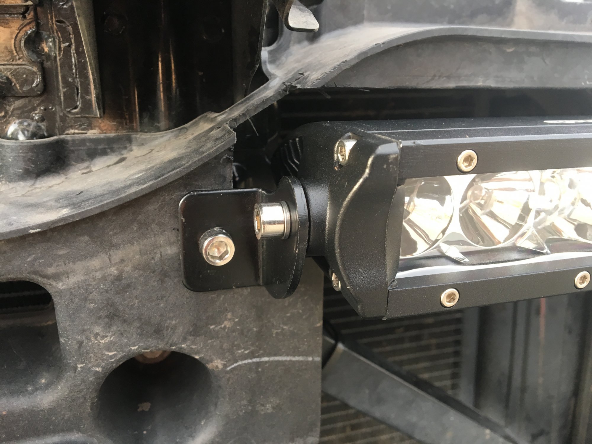

Middle cutout. 1 inch by the width of the light. I used a Ryobi vibration angle cutter with flat blade.
  • Replies 40

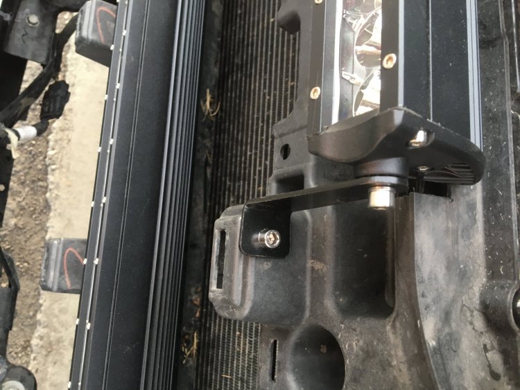

This is the air dam that has to be removed and tossed. 6 retainer (3 on top and 3 on bottom) hold it in place on the grill.
Here is my blue light (Vol FF) install
The light has a slot in the back of it that fits a hex head screw. I thru bolted it to the plastic frame. The bottom of the light sits on the two bosses for the grill clips.

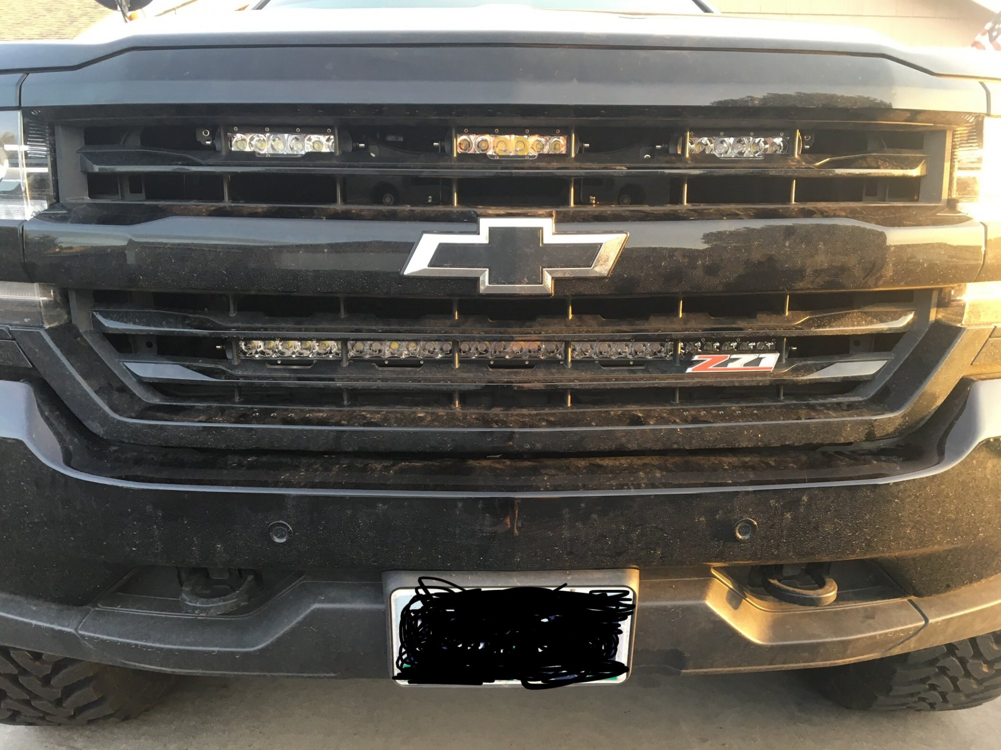

The Special Ops trucks use the dual row, 6” lights from the GM aftermarket shop. They cost around $1,000 for a pair. You would be better off to get (3) of the big names... Black Oak, Rigid, Xtreme, Rough Country, and the likes at that cost. In this thread, On the 2nd page, I did a write up and discriptions of what I used and cut to get single row lights to fit.
Thank you for the information and the pictures Will.... That looks pretty badass on your truck.
