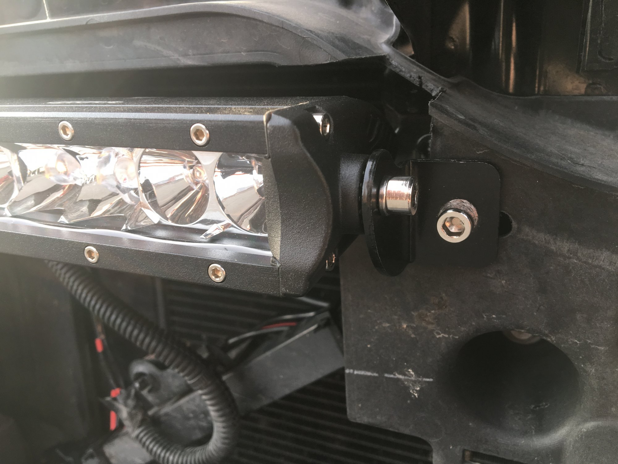

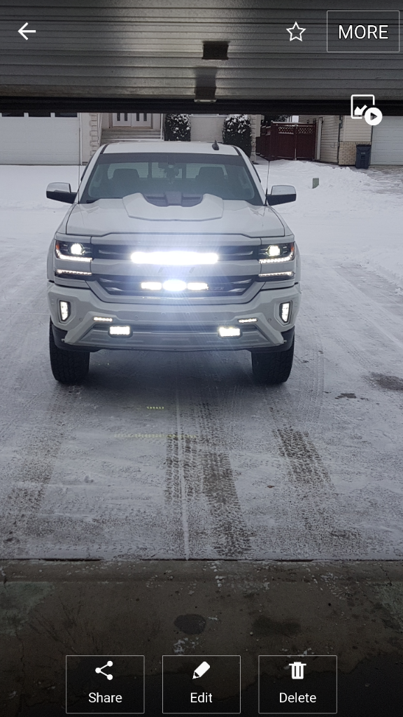

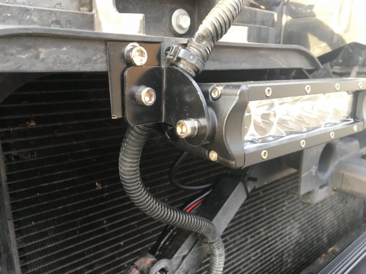

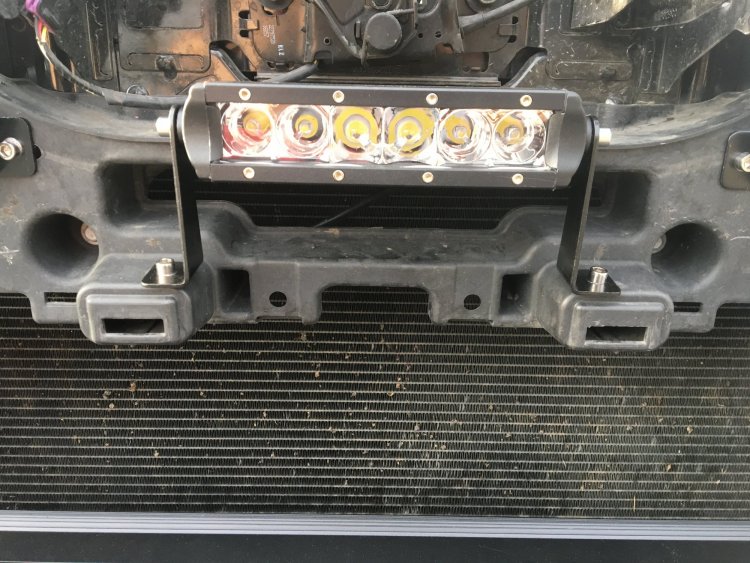

Sorry for bringing this back from the dead a year out. But I finally got around to getting mine done. I mimicked the special ops upper grill (3) 6” single row lights and added a 30 inch single row bar on the lower portion.

3 hours ago, tenscourts said:
How did you do the top row? My 2016 has a plastic air intake behind the top row of the grill.
Sent from my Pixel XL using Tapatalk. My build thread: http://www.gm-trucks.com/forums/index.php?/topic/192614-Tenscourts'-2016-LTZ/Z71-CCSB-4WD-Silverado
Passenger. I used a slotted piece of galvanized iron. Cut to fit with a cutoff wheel. 3/8 hole in the plastic grill support. The cutout was done with a Ryobi vibration angle cutter with flat blade. This is the same for the driver side light.
