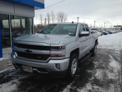

FiremanVan69 Posted September 22, 2016 Posted September 22, 2016 I purchased a 2016 Silverado 1500 Z71 4x4 in January and have some questions due to this being my first Chevy truck. First off this truck has/had horrible hesitation/throttle response when taking off. I pulled out into traffic and almost got t-boned as it seemed like forever before the truck took off. Is this normal when new? Also it has a noticeable vibration when going from 8cyl and dropping into 4cyl mode. Is this normal? Almost feels like it in the wrong gear. Sometimes when driving normal and attempting to pass on the highway it feels like it has no power. It reminds me of driving an old 4cyl car loaded down with the air conditioning on (no power).. I asked the dealer at the first oil change and they looked at me like I had 2 heads. Of course they just said it was probably going through a break in period. Now at 8500 mi it's still a dog..... Any info would greatly be appreciated.
