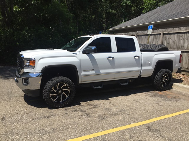

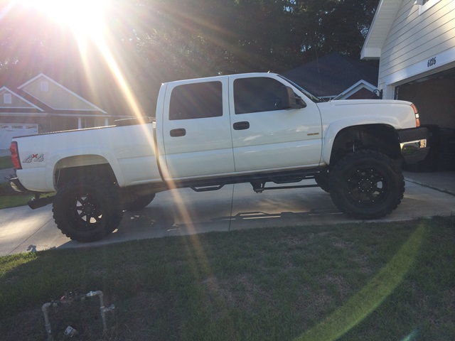

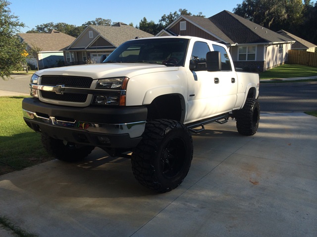

Here is a couple pics of mine.
I've got a '14 GMC 1500 with a 6" and 35s. Really considering upgrading to the new Duramax but will likely wait a while. I've had my truck 2 years and 30k miles and need to get more use out of it for the money I've got in it. Anyways, came to the 2500 forum to see what lift and tire setup people are running and saw your post. The HD sits higher stock and BDS has a a 6 or 6.5" kit that will 37x12.50x20; if they're 20x9 wheels then they won't rub and you won't need to trim. Other lifts out there that fit 35s. Zone, McG.
