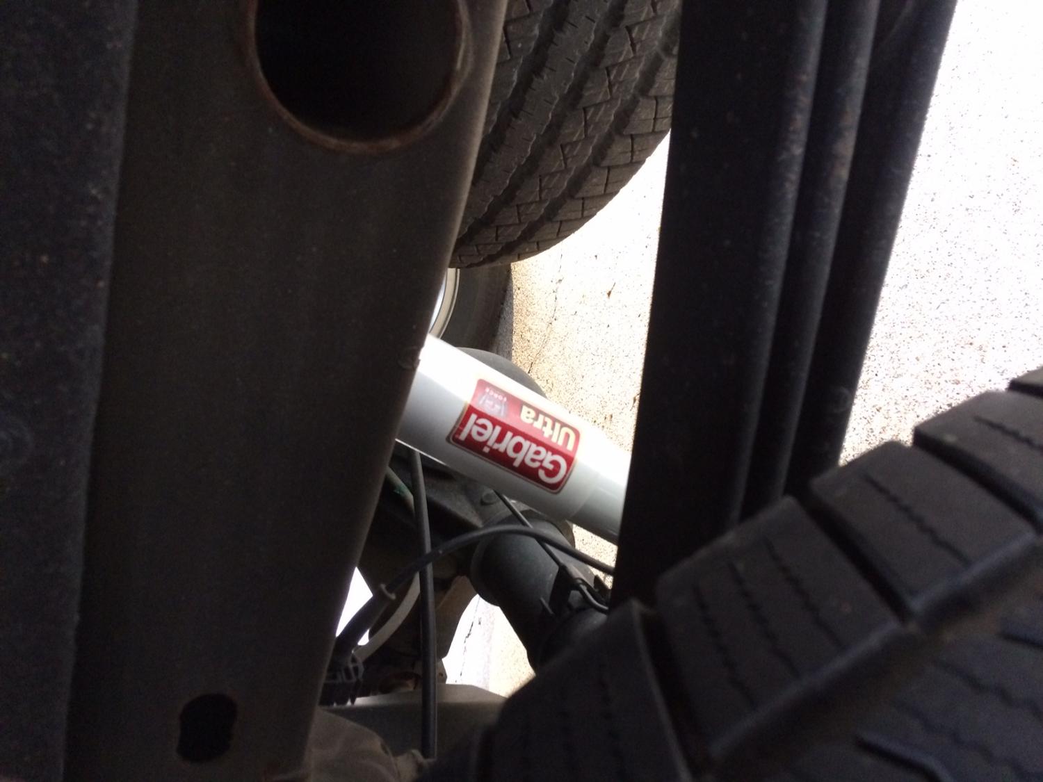

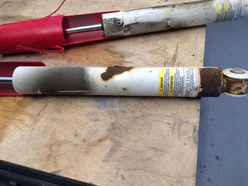

I replaced the rear shocks on my 2014 CC SLT Z71 with Gabriel Ultra Shocks. Cheapest things I could find but when they came in I was a bit shocked by how beefy they were really looked like a quality product at approx 20 bucks each LOL. Factory Ranchos were shot at 50k never did swap out the front ones just traded the silly thing in with 61,000 miles. Pics attached of the rusty Ranchos I cut the shield off so you can see the leaks. Appear to be pretty poor quality.
