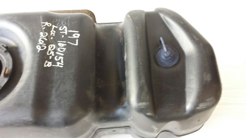

Today it threw P0440 and I hooked it up to a smoke machine to find that the Vent Valve that's mounted in the Fuel Tank has it's end cracked off. Specifically the tube that comes off the valve which goes to the vapor canister. Smoke billowed out of it. I bought the Truck in 2003 and have never touched the top of the tank or had any massive Evap air leaks. Per the 1st pic below the valve appears to have been abused and mangled however today is the first day I've ever even looked at it.

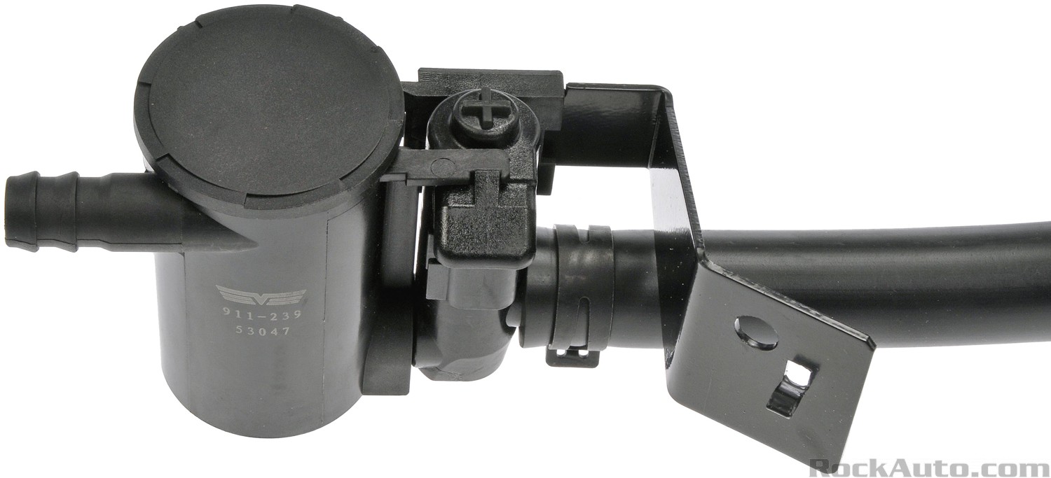

2. A part number 911-001 by Dorman (2nd smaller pic) led me astray as the diameter is about 1.5" and my Vent valve appears to be about 3 to 3.5" in diameter.

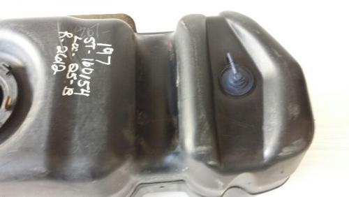

My plan (b4 any Forum feedback) would be to drop the tank and see if I can Drill and tap the existing valve with a 1/8" or 1/4" NPT Tap to accept a male fitting to hose barb, or try and get the old valve out & bond the smaller Dorman valve with Gas Tank Epoxy to a Plastic Disk and then bond that to the Fuel Tank even though that seems real hoaky... However I'm wondering what options any of u may have run into b4 as I searched the Forum and found nothing related to this issue. The last 2 pics show the vent valve (Blue) mounted on tank. Looks like if I can't fix it I may end up driving 6 hours roundtrip to buy a used tank... Scary, unless any of you have any better ideas?

As a follow up on this... I found out today that the Vent Valve is friction welded to the tank and is not removable. Friction welding I'm told offers a better bond then does sonic welding or an epoxy bond, as any contaminates are removed during the process. So I've found 4 tanks that are available supposedly for under $50- if I cannot repair the Vent valve after dropping the tank. Also the aftermarket Dorman Vent valve is for metal Tanks only. I can't tackle this for a week or two but will report back on how I make out.
