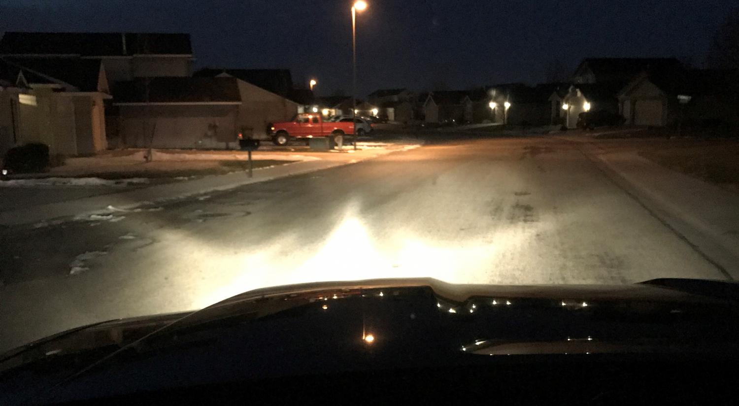

3) The headlights suck. How can I tell if the TSB has been completed on my truck for the BSM higher voltage output? I have verified it has the correct bulbs. I also read the bulbs not being fully seated was an issue, how many degrees does the bulb turn to know it is fully seated.

The headlights suck and they suck a little less after the TSB. So unless you go after market don't expect to much.

That picture of your headlights is definitely not right. There should be a very distinct and clean horizontal break. That looks like what happened to my Sierra after the dealer did the bulb update. I had to re-seat both of the bulbs and re-aim them. I will say that seating the bulbs wasn't totally easy. While easy enough to get to, I made a lot of frustrating attempts to get it to look right and eventually the bulbs seated into place correctly. The key may be to make sure the bulb is held by all the clips, but it takes a while to get it right.
Check post 1503 here for help too:
http://www.gm-trucks.com/forums/topic/185893-headlight-illumination-issues/page-101?do=findComment&comment=1748887
